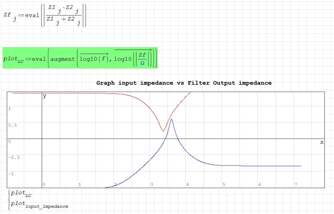

    This is interesting to me... I saw that you were able to make the Z2_j variable match the Z1_j however whenever I attempt to re-type the Z2_j definition as soon as I imput the 1/(s_j * Cin) statement it puts that "j" in the sub-index and doesn't allow me to edit it in a meaningful way.
    So far the only way I have found to fix this is to put in like so: Z2 = "equation here"
    Then once I have the equation finished inputting the defining equation, I go back to the Z2 equation and make it into a vector element, i.e. Z2_j = "equation here"
    Must be a "feature" lol.

    I am struggling to understand how why my new filter impedance is not graphing
    Does it plot on your SS version ?
    When I downloaded the version that had those edits it showed that exact graph that you have posted.

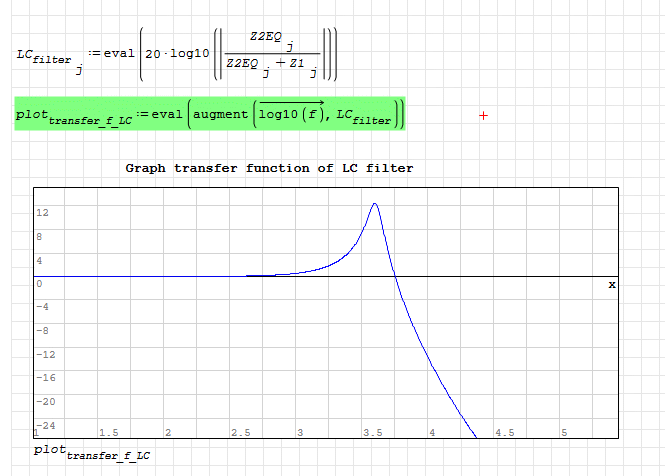

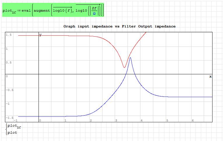

    However, whenever I leave the values as i had them without vectoring them get the expected graph, which matches the TI app note. (see picture)
    Input_Impedance_Graph

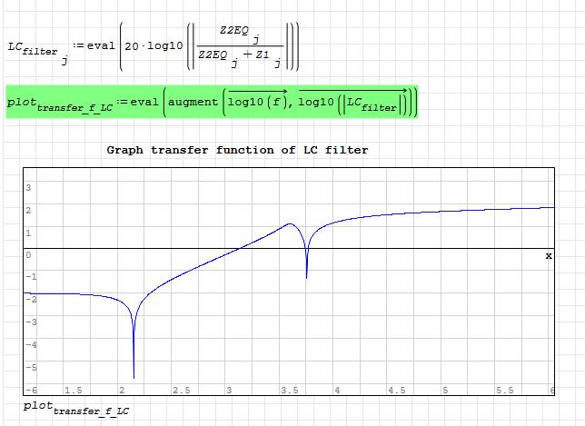

    Now what really confuses me the Transfer function plot looks so different. I input it as the App note stated however the graph seems "negated" as opposed to what I would expect.
    Questionable Transfer Function
    Proper Transfer Function
    Any Ideas Ya'll?

    #6 Опубликовано: 21.01.2020 10:35:03
    Any Ideas Ya'll?
    Same as the other one ... see reply.

    #7 Опубликовано: 22.01.2020 15:07:02
    Hi Carlo. You take twice log10. Just augment log10(f) and LC.filter.

    #9 Опубликовано: 22.01.2020 21:12:50
    bocatto
    bocatto
    0 сообщений из 11 понравились пользователям.
    Hi Alvaro,
    I believe that is what I did? (seriously asking here) See picture
    #10 Опубликовано: 23.01.2020 02:09:22
    Hi. Not in that plot, in the previous:
    Bad: Two logs:
    Ok: One log:
    This other have the same shape, and seems to have the same values than the mathcad plot in the TI app note. Notice that this plot is log only in the x-axis, and the y axis isn't in the log scale in the plot just because you're plotting in dB
    The last plot is log in both x and y axis. See the difference in the green lines. So, you correctly take there here log for both axis
    frapuano 23.01.2020 09:35:00, bocatto 25.01.2020 15:35:00

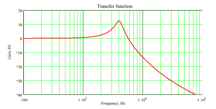

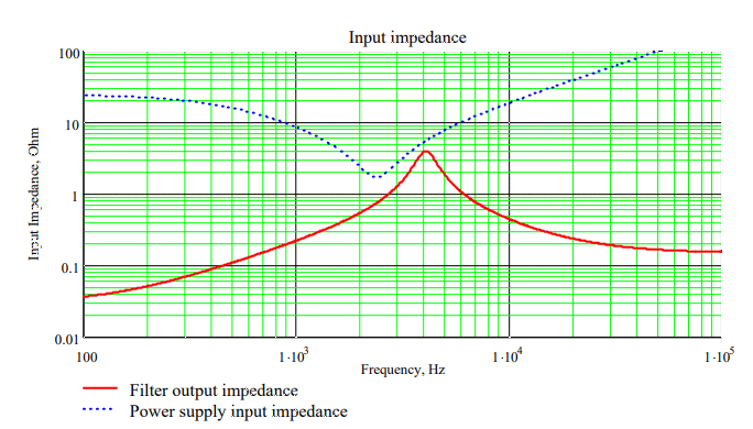

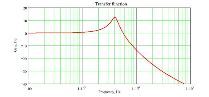

    I have opened a thread here:
    Log based X and Y graph thread
    This will be an attempt to get my graphs to look more like the following
    But hopefully without that horrible green.
