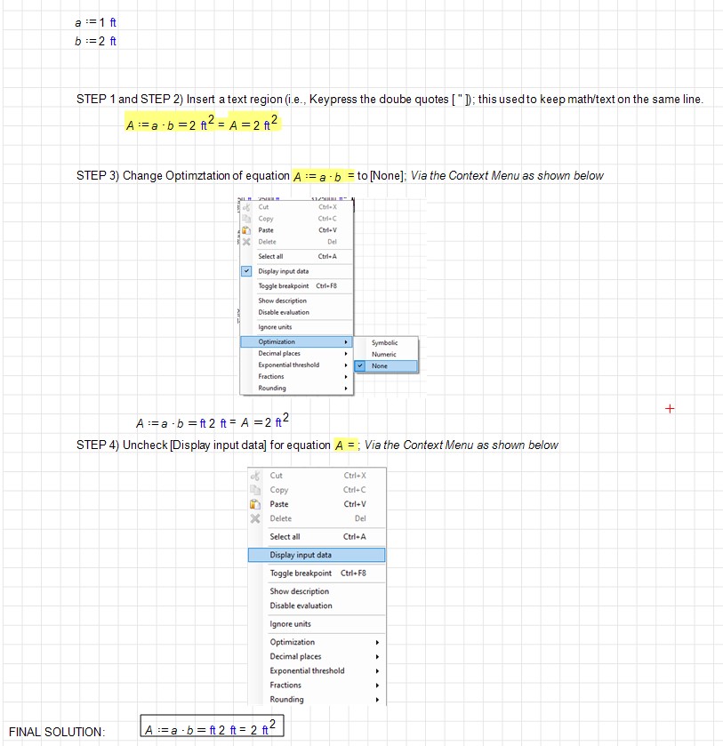

This is possible, but there is some work involved to make it happen. After you define your variables a and b, do the following:
STEP 1) Insert a text region (i.e., Keypress the double quotes [ " ]); this used to keep math/text on the same line.
STEP 2) Type your equation 「A:a*b=#」, the text 「 = 」, and the equation 「A=#」 into your text region.
STEP 3) Right-click your 1st Equation, on your context menu you will see [Optimization]; change this option to [None]
STEP 4) Right-Click your 2nd Equation, on your context menu: uncheck the [Display input data] option.
NOTES: With units, it will simplify 「1*m」 to 「m」; so this isn't a perfect solution by any means.
Reference post #8 on forum: https://en.smath.com/forum/yaf_postst17400_Edit-workflow-for-text-regions-with-embedded-math.aspx
Example:
Here is a file with an example: SMath - substituting variables into same equation.sm (46,02 КиБ) скачан 1406 раз(а).
Hope this helps!
Kenny Lemens, P.E.

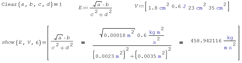

Hi. It would be great to have a new equals sign, such as ≡ , that shows the substitution of an expression for its values, but without the rounding problems that this proposed solution has, and showing the final result in Pascals, perhaps.
show.sm (14,6 КиБ) скачан 1414 раз(а).
show.pdf (56,88 КиБ) скачан 819 раз(а).
