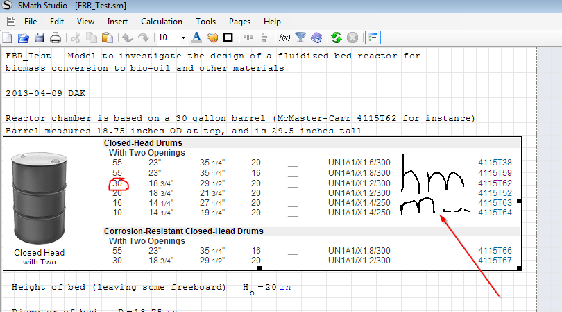

I created (in Windows 7, SMath Studio version 0.95.4594) a worksheet for a set of calculations I was working on. I embedded an image in the sheet (Copy->Paste) (see attached).

FBR_Test.sm (49,15 КиБ) скачан 1443 раз(а).

It seems that the problem of freehand drawing on picture region still remained in Linux. I've seen this long time ago on some older SMath versions and I thought it was fixed.
Hmm... it seems it is still present in this SMath file in Windows as well
I do not remember when is this happening ? If we use "Insert|Picture|Create" we get a blank region a and there we can draw with a mouse. I remember (and I checked it out) that when we use "Insert|Picture|From file" or we insert a picture from clipboard that there is no possibility to freehand draw inside picture region.
Now I am puzzled and can not understand how Duane inserted that picture...
Duane, can you please tell us how did you insert that picture inside the SMath document?

Omorr, I did the following as Duane stated:
I sent one of these images to the clipboard and copied it to Smath with ctrl+v, then mouse drawing is allowed by making right-click over the image and selecting 'edit'.

Yes you are right. I forgot the right-click on the picture and "Edit" option from the context menu, sorry .
This option just suppress unintentional drawing over the pictures. I do not know any other purpose of this option.

Thanks for taking time to look into this. I would really like to be able to freely share documents between Windows and Linux.
So, I created the embedded picture by using the Windows 7 Snipping Tool (snipping from a Web browser window), and circling in red the size I wanted to indicate in the picture (I circled it with the pencil the Snipping Tool provides).
I then Ctrl-V (pasted the clipboard) into the SMath sheet
Again, please let me know if you need any more information, or want me to run other tests.

I would also like that SMath documents can be freely shared between Windows and Linux. But it seems that this is not that easy at the moment. When would that happen - I do not know. That just depends on SMath author, Andrey Ivashov. I think there is no other way for the moment, just to wait and hope.
On the other hand, I was a bit out of topic and I am sorry for that. I just forgot the "Edit" option regarding pictures which just disables the behavior of freehand mouse drawing on the picture region (a strange option present in previous SMath versions). I do not believe (can not be sure, of course) this has any connection regarding pictures and Windows<->Linux SMath files.
