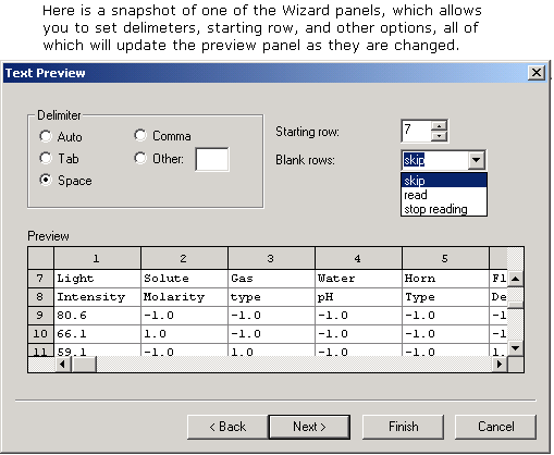

I was meaning that the csv import is quite restrictive in the type and format of data it accepts.
The particular csv file has a different number of null entries per line, and the dataimport.csv function just ignores these rather than filling the matrix column with something like "" or 0
It also seems to dislike mixed types of data : some columns text, and some numeric
I could handle the date and time if inherently able to be imported as string.
For this data analysis job I was trying to avoid the extra step of importing the csv to excel, massaging the data in excel and then saving before bringin into SMath.
You can use the Script component to parse any file as you want. But this will require some programming knowledge.

Puzzling your comment ... maybe from punch card days.
like "" or 0 ... or NaN
