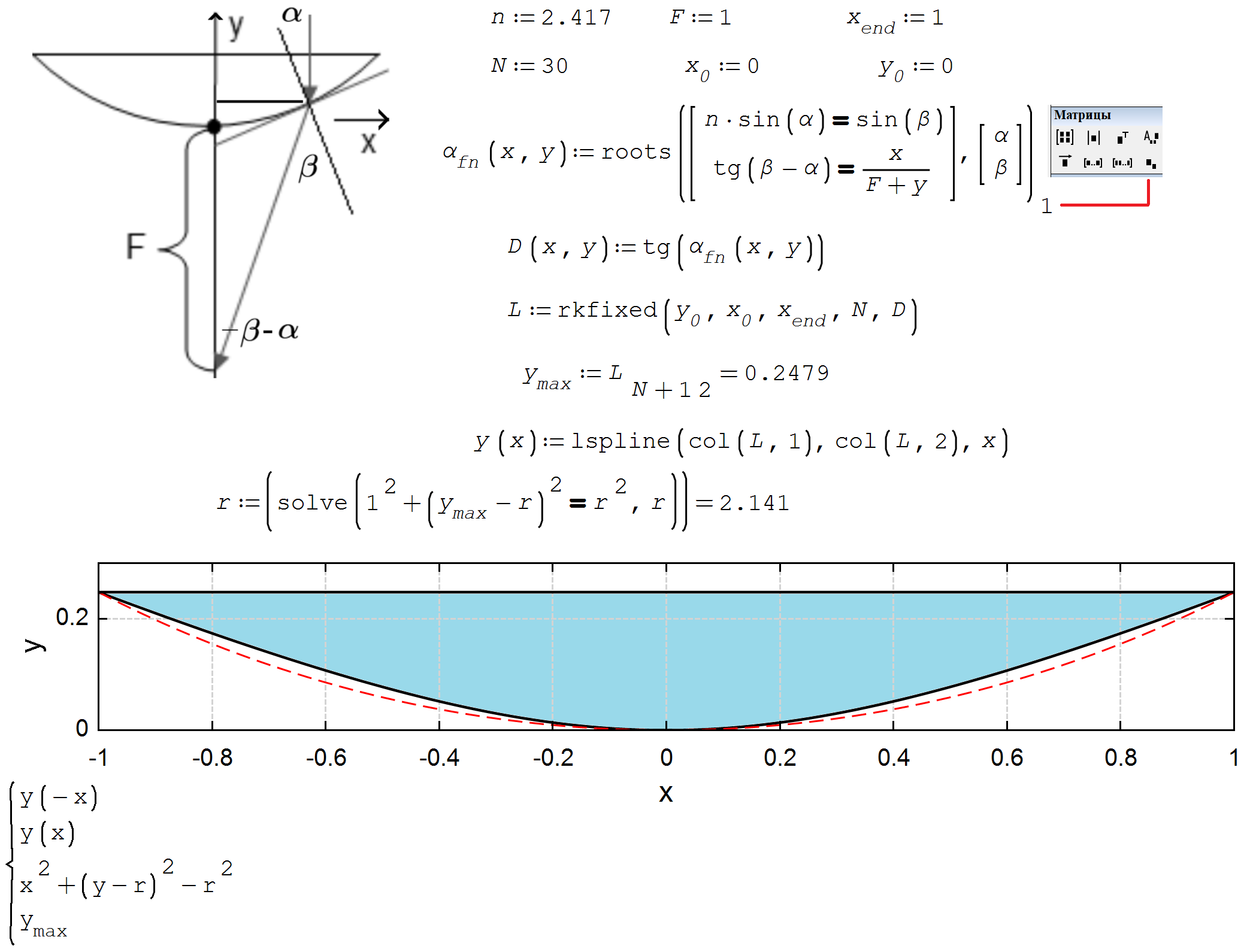

Looks like the algebraic relationships need to be separated out:
Lens_stv.sm (363,89 КиБ) скачан 1706 раз(а).

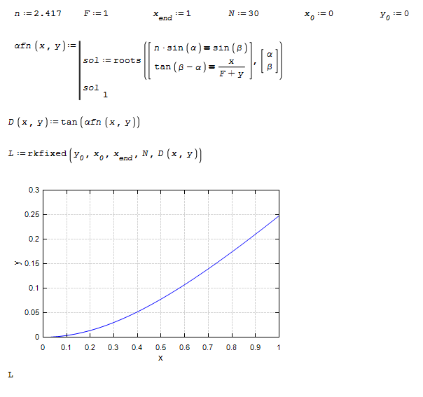

New question.
Can we use here the Mathcad-block for ODE solution?
See please the attach
Lens.sm (118 КиБ) скачан 1604 раз(а).
#4 Опубликовано: 01.05.2024 14:07:58
Valery Ochkov
Valery Ochkov
67 сообщений из 713 понравились пользователям.
The solution at N>30 and with units
Lens-Euler-RungeKutta.sm (59,18 КиБ) скачан 1661 раз(а).
