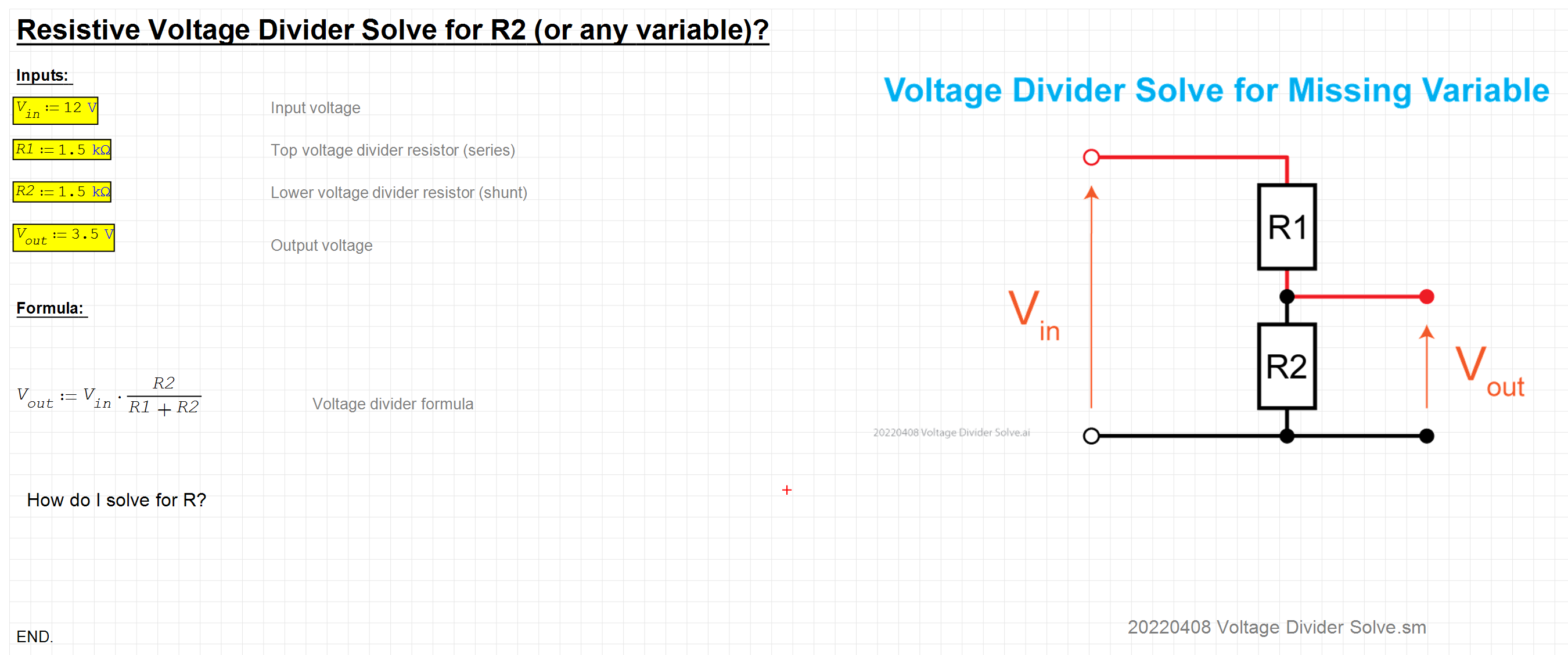

I've been unable to solve this (pardon the pun):
Показать спойлер
20220408 Voltage Divider Solve.sm (36,77 КиБ) скачан 1223 раз(а).
Any thoughts?
Thank you in advance.
Mark

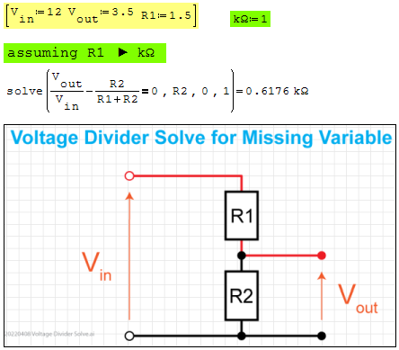

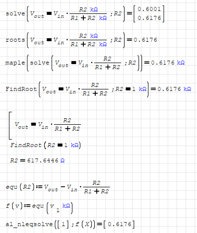

#2 Опубликовано: 08.04.2022 09:25:46
You have defined R2, maybe that's why you can't solve.
First you need to be sure calculation variable cleared.
And if you defined your function, it will also prevent the solution.
Some remembrance for smath solvers;
solve(), roots() and al_nleqsolve() won't work directly with units.
You have to trick them for units, adding into equations.
Maple solve and FindRoot() can work with units.
I also included mathblock method, which relies on FindRoot().
If your root is beyond -20,20 you have to specify it for roots() and solve().
Unless you didn't already change Root Ranges in options.
And you also have to guess a starting point for FindRoot().

Resistive Voltage Divider Solve for R2 (or any variable)
Greetings Mark,
For your first part, you can copy and paste this formula (solved for R2):
R2:{R1*V.out}/{V.in-V.out}
For your second part, please reference the following forum topic: https://en.smath.com/forum/yaf_postst21770findunread_solving-simultaneous-equations-with-Solve.aspx
There is a healthy discussion of various methods to solve for an unknown variable.
Hope that Helps!
-Kenny Lemens, P.E.
