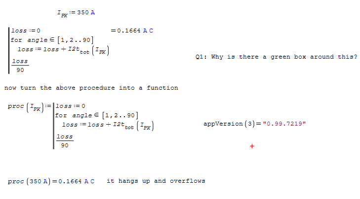

Firstly thank you for such a wonderful free alternative to MathCad 15.
Please see attached .sm file.
The comments describe the bug ...
Thanks in advance
test bug.sm (16,34 КиБ) скачан 1446 раз(а).

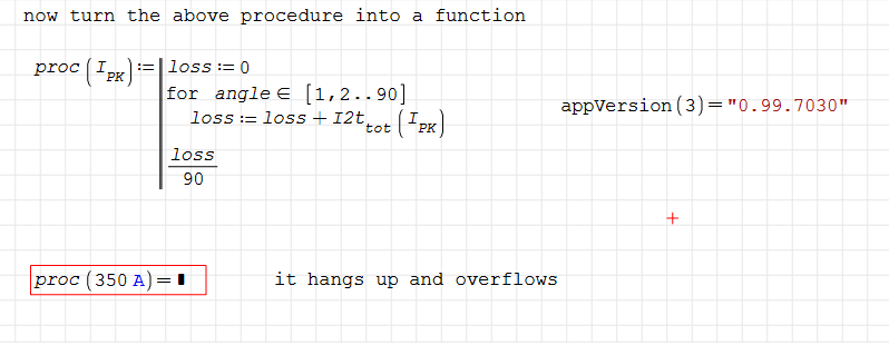

Hmm,
I just re-tested on my home PC, freshly booted, same problem.
appVersion(3) = "0.99.7030" not .7219 <- Could this be the difference?

I can confirm this hangs on 7030. I was running 7219 before and did not have an issue. My guess is this should be fixed in next stable release and already seems to be fixed in Beta releases. The question is whether or not the "fix" is intentional or not.

angle was originally used as such, but I modified it as a troubleshooting step, with no change to the bug's behavior
loss := loss + I2ttot(sin(angle*deg)*Ipk)
