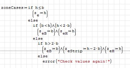

any way i can print a message in a for loop?
i have 3 cases that change 2 variables, but it would be useful to know in which case i'm in
thanks in advance
#6 Опубликовано: 14.03.2013 10:08:17
Something like this?
regards,

#7 Опубликовано: 18.03.2013 08:31:18
dan
dan
yes that did it,
thank you
