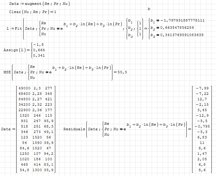

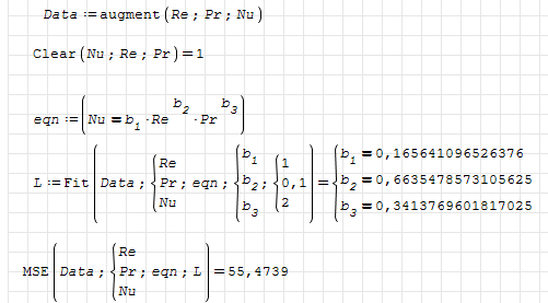

#6 Опубликовано: 22.02.2019 15:05:36
For example, like this one (also remained unsolved for me in SMath for years)
linfit_multiple-1.sm (22,94 КиБ) скачан 1241 раз(а).
I don't know whether this counts as a reasonable fit, but at least you get a solution.
linfit_multiple-1_Kr.sm (162,77 КиБ) скачан 1216 раз(а).
Edit: second example shows the same MSE, and nearly the same b2 and b3.

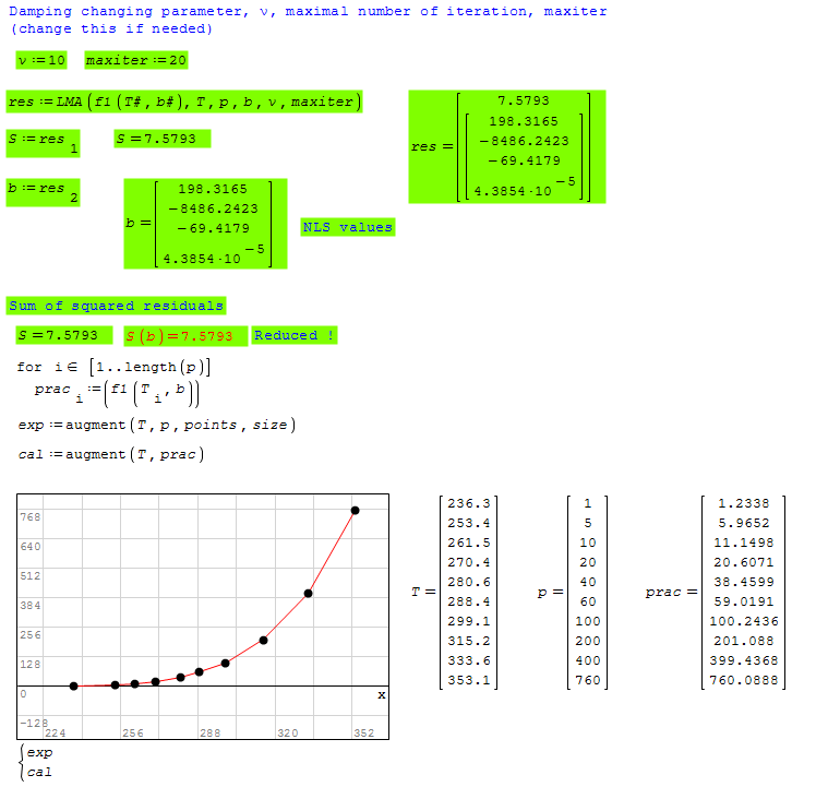

#7 Опубликовано: 22.02.2019 15:10:36
Hello Radovan, let me examine your unsolved examples.
... part 1 NLMinimization-9c doctors by itself
... part 2 LM complains ,,, not doctored yet
Thanks for this LM
NLMinimization-9c Scrap.sm (43,34 КиБ) скачан 1197 раз(а).
#8 Опубликовано: 22.02.2019 16:26:00
Thank you Martin. It was a direct answer to my question - Fit() function from Maxima. Thank you for reminding us of this once more. Fortunately, we have Maxima plugin for nonlinear fitting (it slipped my mind) and I am glad that I was wrong. I also would have liked to be wrong by saying that this is the only function in SMath performing this task (maple plugin maybe?).
