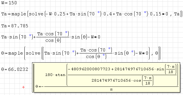

I found this behavior working with Maple plugin:
arctan() function not defined
I think that it would be easily fixed by uni
Thanks in advance!

I think that you can use directly:
ExpressionString = ( new Regex( @"\batan\(" ) ).Replace( ExpressionString, Functions.Arctg + @"(" );
ExpressionString = ( new Regex( @"\barctg\(" ) ).Replace( ExpressionString, Functions.Arctg + @"(" );
using the Functions.* you don't need to write the right SMath function name.
best regards,
w3b5urf3r

Oscar, could you attach the file and the log (mvr5.txt)? As for me your example works fine.
Here the files.
Thanks in advance!
Oscar

Fixed and updated. Try now.
