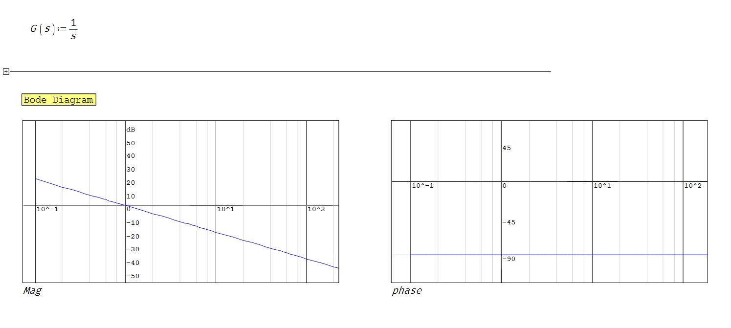

WroteHi Cornel,
This can help you:
Please see this post
Change H(s) for your own
bodeplot_smath.sm (71,46 КиБ) скачан 1863 раз(а).

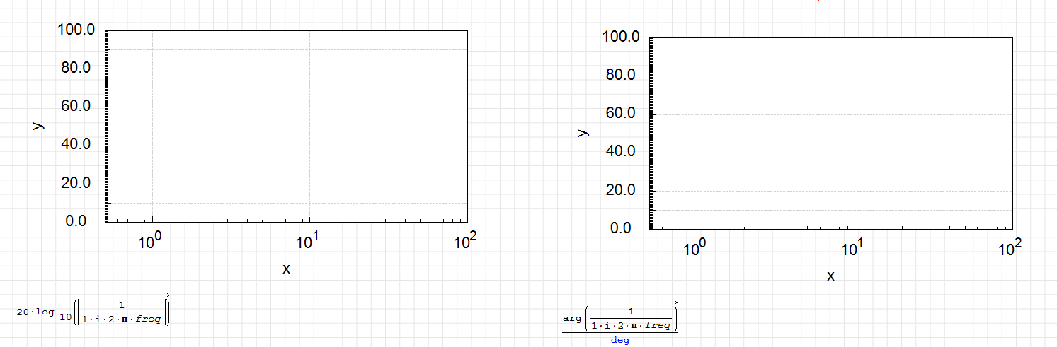

But how can I plot these 2?
WroteCornel,
The arguments for a plot must be a function or a couple of column vectors.
I your case you can use in your plot the vectors you are calculated and use as input for the graph:
Best,
Oscar

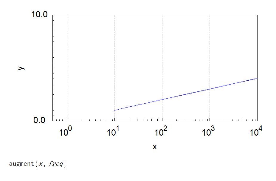

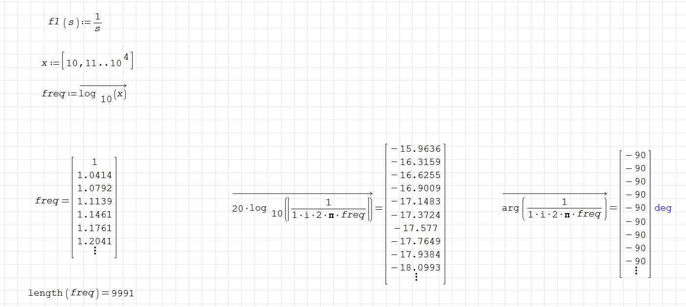

But I want to plot augment(freq, 20*log()) and augment(freq, arg()), which does not work..this îs the problem
Wroteaugment(freq, arg()) and augment(freq, 20*log()) really works... only must adjust the axis... your yaxis is set 0~100 and your data appear in the 0~(-100) axis

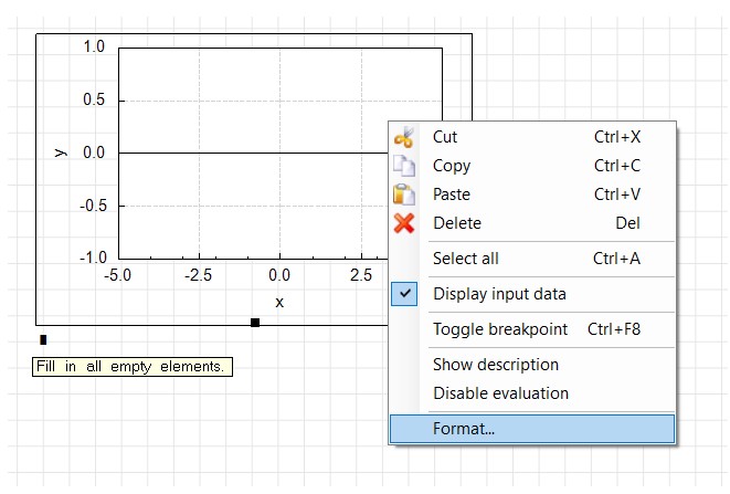

I'm starting to dislike Smath's problems/bug and that is not working continuously fine...2 days ago I could see the Zedgraph settings, and now when I try to enter in the settings of Zedgraph, Smath crashes...

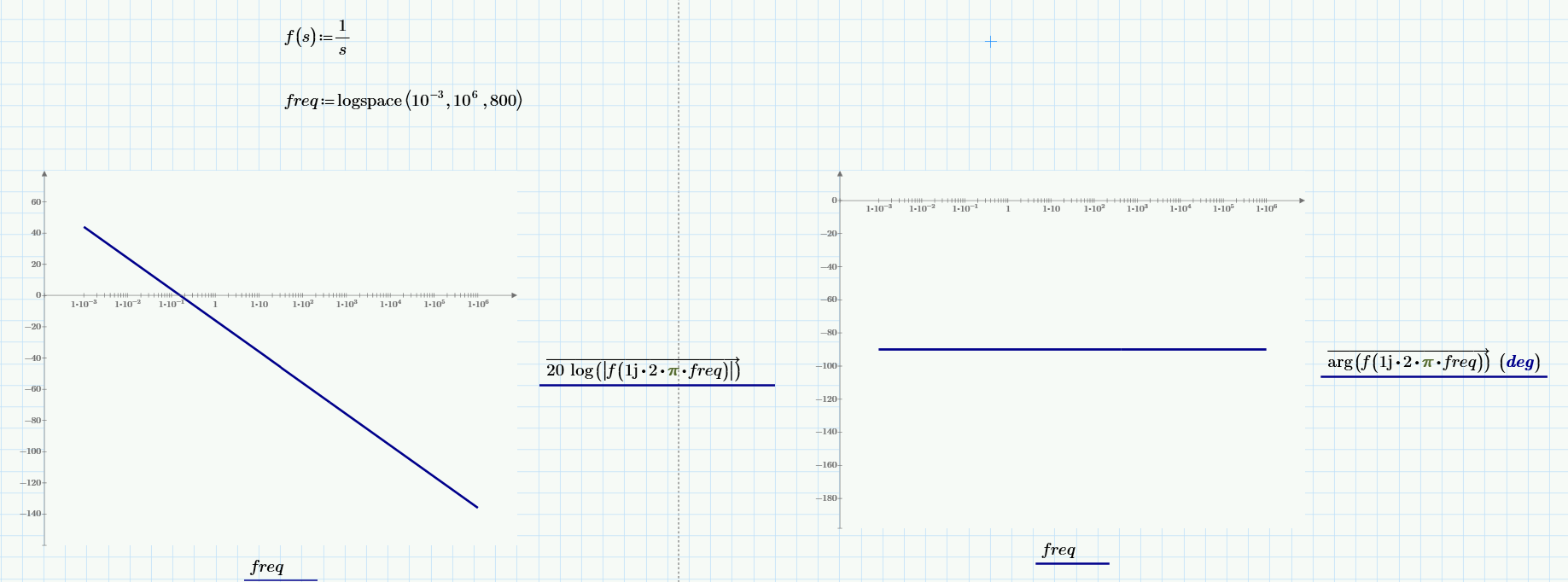

I'm trying to give SMath a try because I like that it has better symbolic calculation capabilities than Mathcad Prime, but I also see SMath's shortcomings or things that are easy to see in Mathcad Prime but not in SMath...
