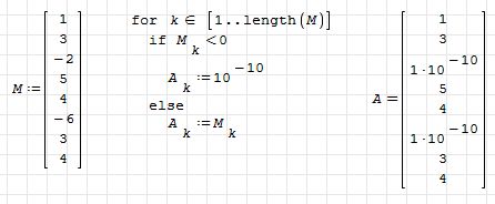

Hi. Something like this?
vector.sm (6,15 КиБ) скачан 1120 раз(а).

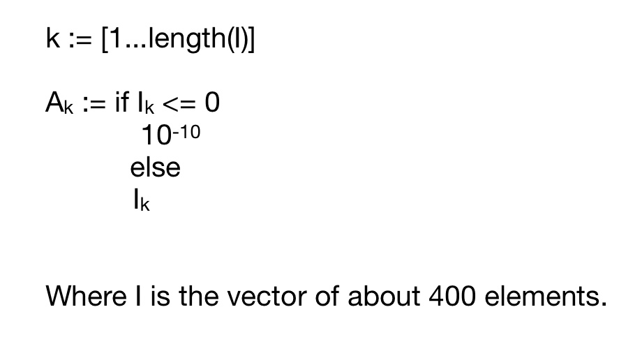

What if I don’t know the positions that need changing ahead of time? In my vector of about 400 elements, some values are negative. I would like to change only those values to about 10^-10 or take their absolute value and leave all the other elements of the vector unchanged because I plan to plot the vector on a log-log plot.
This is quite easy to do in Mathcad, but it seems SMath doesn’t have the same capability. When I try to test on a value of an element using SMath’s if statement to see if that vector element needs changing I get syntax errors in SMath.
I was hoping to use something like this, but it doesn’t work.
k := [1...length(I)]
A[k := if I[k<= 0
10^-10
else
I[k
Where I is the vector of about 400 elements
Forgive the [ since the forum doesn’t allow subcripts or less than or equal. I am on my iPad now and the forum also does not allow uploading jpg from my photos.

1 125 сообщений из 1 798 понравились пользователям.
This?
vector.sm (4,61 КиБ) скачан 1072 раз(а).
#6 Опубликовано: 08.03.2019 04:54:10
RegCurry
RegCurry
0 сообщений из 57 понравились пользователям.
Thanks much. I thought I tried that in using a program line, but I guess I had some typo.
Thanks again!

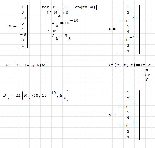

#8 Опубликовано: 08.03.2019 04:58:28
Hi. The method in your picture, using range vectors, fails because 'if' have an special evaluation method, For instance, the true or false parts are evaluated only if the condition results in true or false, respectively.
This method is a workaround, but isn't very efficient.
vector.sm (7,5 КиБ) скачан 1086 раз(а).

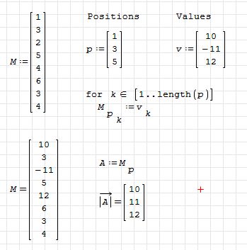

Is it possible to assign specific values to specific elements
The attached is not exactly what you are looking for,
suggestive of Bolean Find-Replace in matrix.
Your 400 long vector is not easy to inspect, you can Pack in matrix,
probably Find-Replace in that more visible Packed matrix, then
Unwrap the processed matrix back in vector.
IMHO, it does not make much sense to |absolute| a vector.
Does it mean the vector-creator is under-designed ?
Matrices-Vectors ... what you do in Mathcad, Smath does.
Easy to select-collect position of elements in vector,
then replace those selected elements by new values.
You seem to have several demands to the "Cat in the hat Fairy",
Maybe she has all and +++
Utilities Matrix Find_Replace.sm (21,22 КиБ) скачан 1092 раз(а).

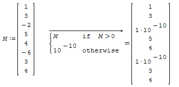

#12 Опубликовано: 08.03.2019 12:10:27
vector(1).sm (3,9 КиБ) скачан 1087 раз(а).
sergio 08.03.2019 12:47:00, NDTM Amarasekera 08.03.2019 13:12:00, frapuano 08.03.2019 18:02:00
