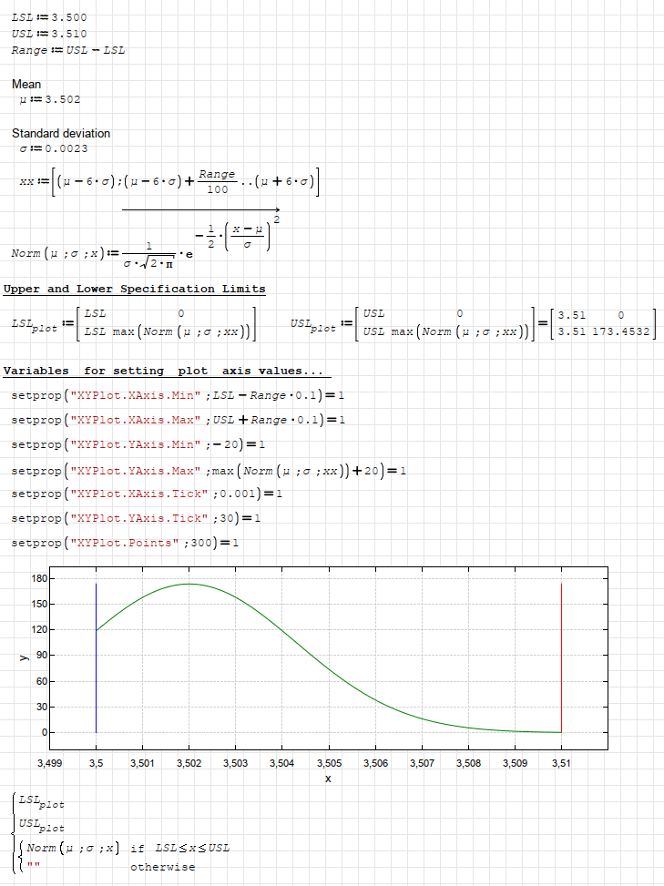

This is a continuation of learning to plot in Smath, heck learning Smath.
I have been able to get the XYplots correctly done.
But now I am searching for a solution to define the x- and y-axis min maximum values using calculated values (See the Variables for setting plot axis values ... section).
I am aware formatting X-Y Table, but have not been successful in using it as a place holder for the calculated values, all seems to be static.
Looking forward to your responses.
Lloyd

There is a function to change the XYPlot settings, setprop().
Here is a demonstration for your file.
And below you can find examples for setprop() settings.
2D Plot - Axis Control_r1.sm (14,61 КиБ) скачан 1261 раз(а).
XYPlotTools.sm (48,94 КиБ) скачан 1289 раз(а).
