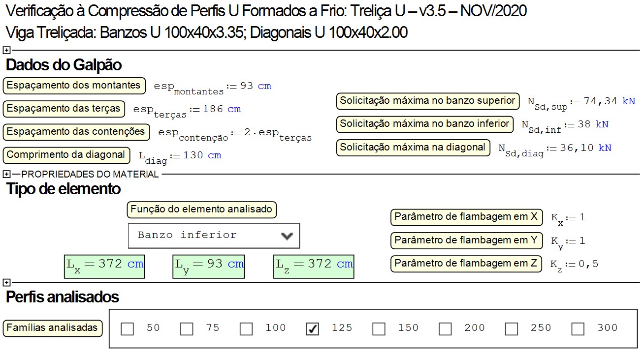

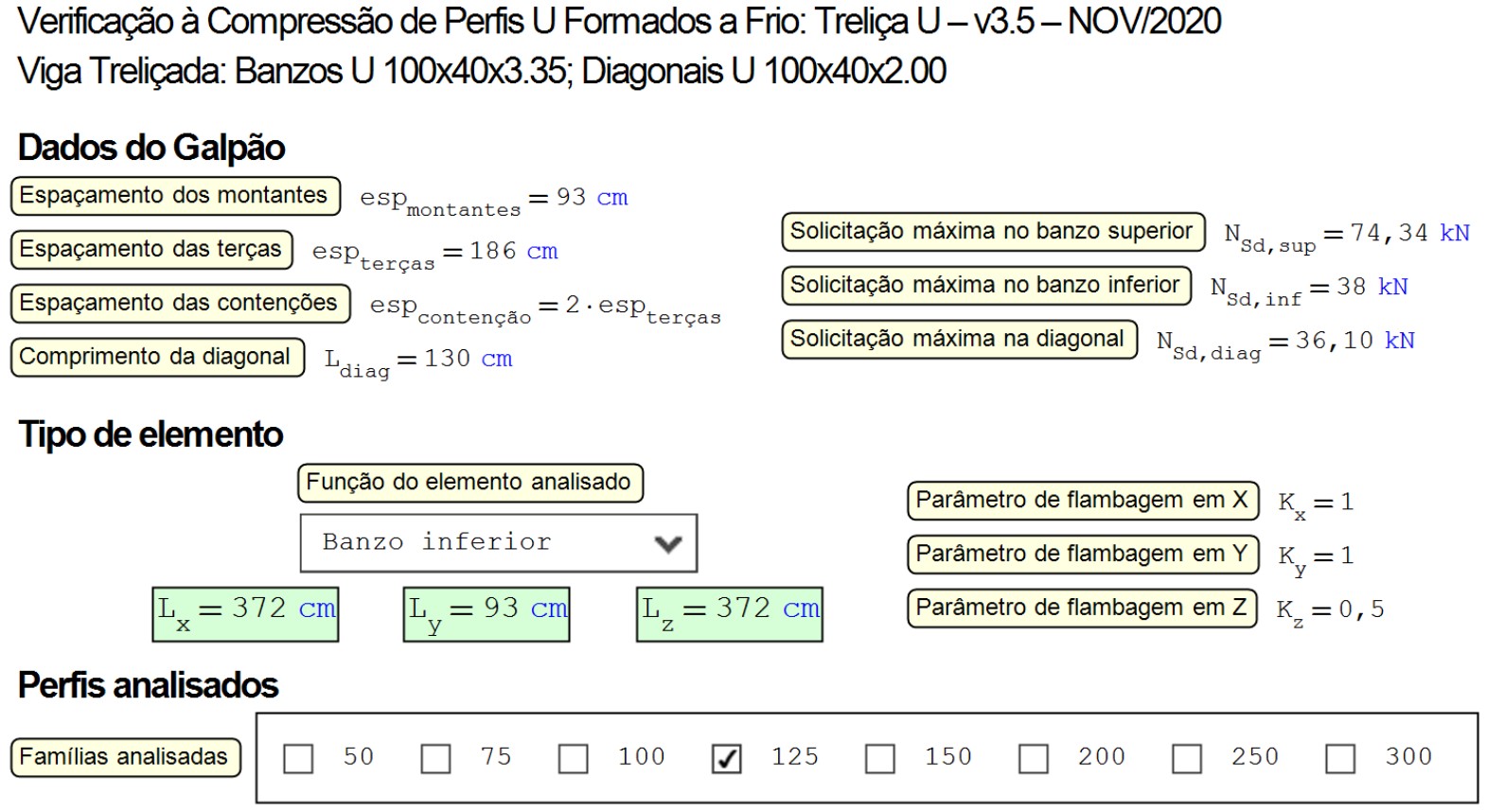

Hi, Jean! I'm not sure you understood me.
Here I have my script:
And here I have the PDF generated:
I'd like to remove the extra space above wich section title, where there were area regions.

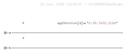

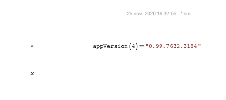

Hi. This behavior seems that happen only with print as PDF. Try to "Save as PDF" instead. Regions appear then in the PDF.
Saving as PDF:
Printing into a PDF file:
PD: Thanks four your greats tutorials.

Hi, Alvaro! Actually, my Save as PDF omits the area regions, but leave the extra space.
When I try to print as PDF, my Windows crashes every single time, so I don't even bother trying it anymore.

I'm surprised it worked now. I haven't tried it for a while. That's great. I use Foxit Reader by the way.
The vertical spaces once occupied by the area regions still there.
