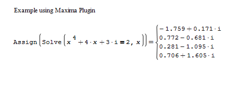

Here an example solved by using Maxima plugin:
best,
Oscar

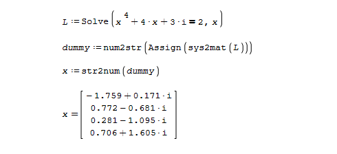

How to put these answers of Maxima plugin inside a vector?

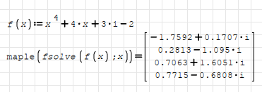

You can use maple() too.
Maple has a fsolve() function.
Which uses floating-point arithmetic.
A little trikiest

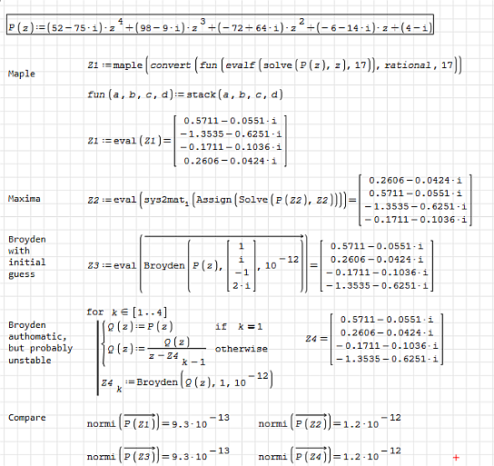

Hi. Another way.
zroots.sm (19,36 КиБ) скачан 1430 раз(а).
Oscar Campo 19.11.2023 03:45:00, ioan92 19.11.2023 03:49:00
