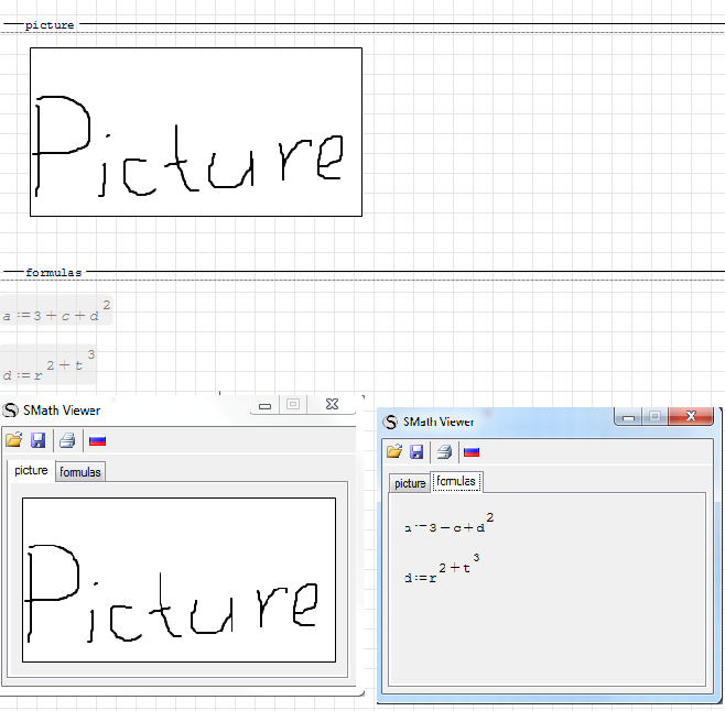

Hello. Please help
On the program sheet I have pictures, a set of formulas.
When I create an .exe file I get it.
But, I would like so that instead of pictures and sets of functions there was something like a button or hyperlinks (or something similar) by clicking on which, I would already receive my picture or set of functions in the form of files .xls, .doc, .pdf or others
Файл не найден. Файл не найден.
Thanks!

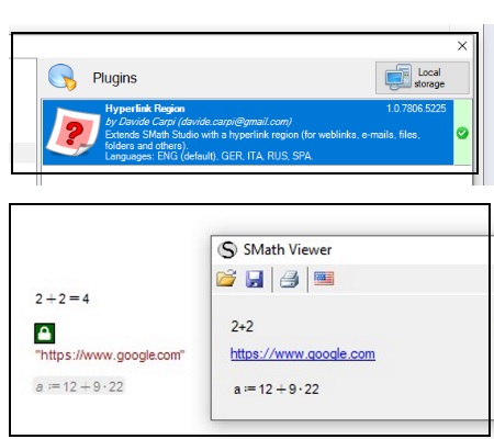

Greetings,
You can use some plugins to create this functionality. For instance, add the 「Hyperlink Region」 to your calculations; this will result in the iconic hyperlink as shown below:
May this be of Good Help;
⚜ Kenny Lemens, P.E. ᵂᴵ

A good option with a hyperlink.
What if you need to link to a picture or file?
#4 Опубликовано: 19.07.2024 23:14:10
You can find the documentation of the region here: hyperlink region
