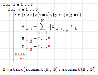

#2 Опубликовано: 17.11.2015 20:50:10
You have to define A,B,D in a loop, then you can merge the matrices using augment(...) and stack(...)

#3 Опубликовано: 18.11.2015 05:25:23
archbuilder
archbuilder
Thank you this works very good.
