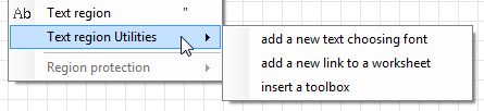

This plugin adds a couple of items in the "Insert" > "Text region utilities" menu to add new text regions with custom fonts and/or with links.
A "Toolbox" region is provided to do more actions on the worksheet (edit text/links, add links from paths, convert TextRegions into WriterRegions, search and replace text in the whole worksheet)

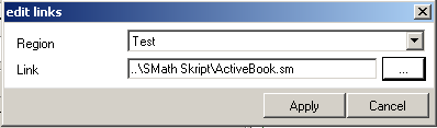

- toolbox: "edit links..." now works
Martin Kraska 04.03.2014 08:45:00
#10 Опубликовано: 04.03.2014 08:26:52
Hi Ioan,
- The toolbox needs a refresh of the page to capture all the text regions;
- Then you can choose a text region and add (or delete) a link to another worksheet;
screencast
If there are problems, let me know...

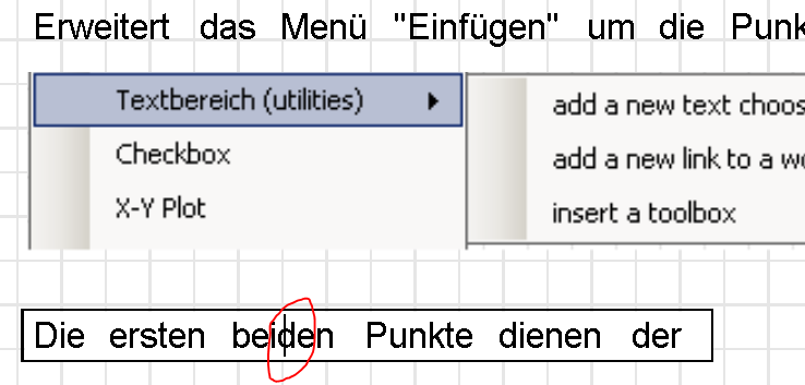

There are cursor placement issues in texts with non-monospaced fonts. May be that is a reason why font change is not supported natively so far.

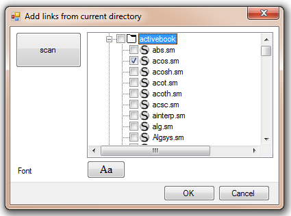

#18 Опубликовано: 11.08.2014 17:00:14
UPDATED SMath Studio 0.97.5329
- Plugin recompiled (fix SS-203 on Linux systems)
#19 Опубликовано: 04.09.2014 08:45:34
UPDATED SMath Studio 0.97.5346
- Toolbox: new feature "add links (batch)";
- Fixed bug on auto calculation disabled;
- Libraries updated.
add links (batch)
  • This feature explore all folders and sub-folders from the path of the worksheet, looking for *.sm and *.smz files;
  • If the worksheet is new (not saved somewhere) the option is disabled (if the file is saved and the option is still disabled try refreshing the worksheet);
  • You may include or not the files using checkboxes on a tree view;
  • Any link created is relative to the current location of the worksheet;
  • Links are added below the toolbox, regardless what is already on the canvas, using the same horizontal alignment.
Martin Kraska 04.09.2014 08:54:00
