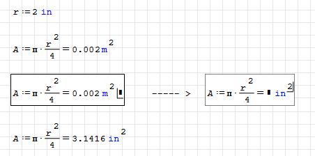

#5 Опубликовано: 15.07.2020 18:29:56
... make it hi-pro algo style.
#9 Опубликовано: 15.07.2020 19:37:25
Unit Silent.sm (5,5 КиБ) скачан 1064 раз(а).

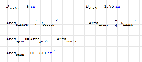

#11 Опубликовано: 16.07.2020 11:41:59
tonlok
tonlok
Once again, I want to thank everyone for their help.
I am going down the path of using the units. Took me a couple of attempts to get the in2 but it is now working
One follow-up, if I set the equation to optimization none to show the numeric values they all default to meters, is there a way to have them shown as inches?

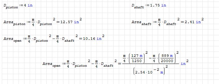

#12 Опубликовано: 16.07.2020 13:33:43
Construct as is, it may have to do with your SS version.
Otherwise, you are wrongdoing, not following guidance.
#13 Опубликовано: 17.07.2020 04:29:22
1 355 сообщений из 2 271 понравились пользователям.
Definitions are converted to SI upon storage (you see that when you hover with the mouse over a definition. Control of display units is just by the optional placeholder, where you can insert any factor (a unit or pi or any variable name which your result may contain)
Also note that the default display unit depends on optimization. Numeric and symbolic display different units, e.g. 1/s defaults to Hz in numeric optimization and to 1/s in symbolic.
