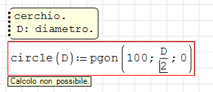

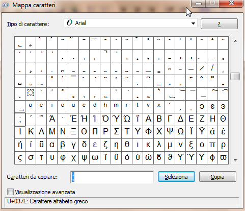

Thank you Martin,
The issue is related with a previously reported SMath bug: str2num problems with regional settings (2nd post); Waiting for the official fix, I've reuploaded the file with an hidden hack (I've used the greek semicolon ; instead of the latin semicolon ; ).
About the GPC plugin I think will be useful an english translation for this side of the forum (all examples and screenshots are in russian)
best regards,
w3b5urf3r

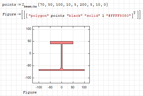

To the point, Is it possible to arrange the calculation for horizontally asymmetric I profile? Such as following
Asymmetric profile
Thank you!
#9 Опубликовано: 24.09.2018 04:27:16
of course it is possible
Ibeam_ha.sm (23,43 КиБ) скачан 1570 раз(а).

Thank you for such a prompt response
If you dont mind, I would like to ask you for short explanation. Ive tried to make it by myself, everything was clear except the part with the fillet. Ive got it flipped around vertical axis. I would really appreciate short explanation to understand it completely . Maybe with simple sketch ?! No need to hurry.
Thank you again
Daniel

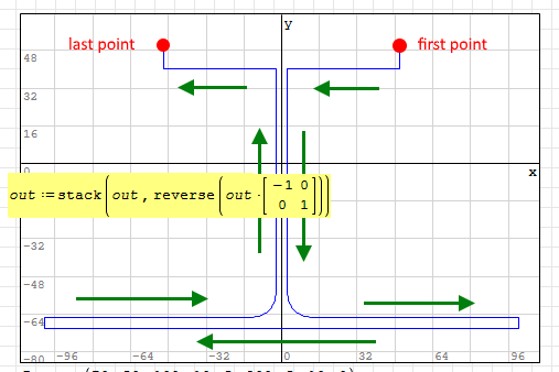

#11 Опубликовано: 24.09.2018 07:55:01

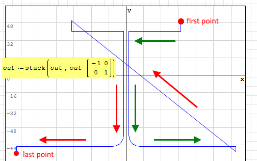

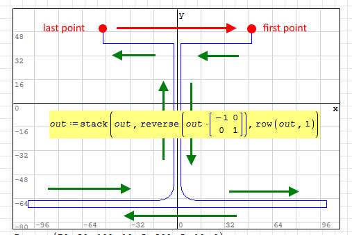

Sure!

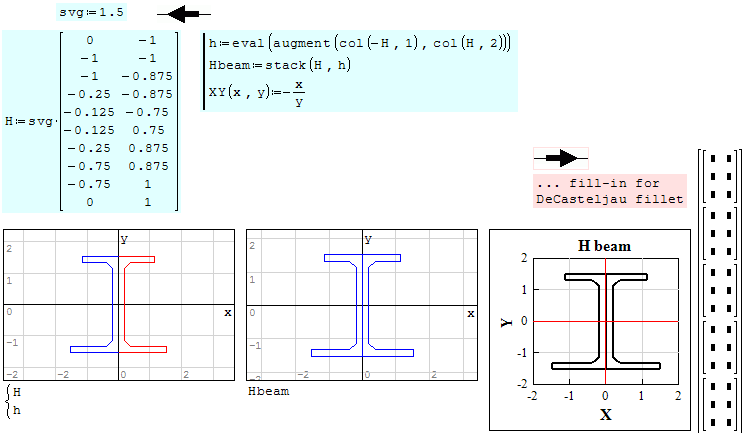

First of all what we want to archieve is to draw the shape using less points and operations as possible.
  1. Taking advantage of the symmetry we draw one side
  2. Once we have the points, the other side can be drawn by symmetry using the symmetry matrix multiplication, then stacking the points; the problem is that they aren't sorted in the correct order
  3. This can be solved by using the reverse() function
  4. To close the figure then what you need is only to add as last point the first
(I've cleared the eval() that aren't needed)

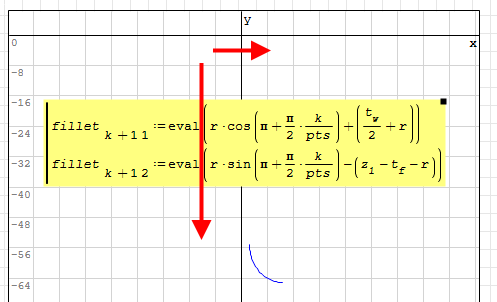

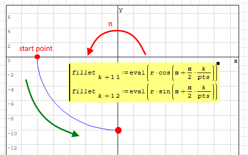

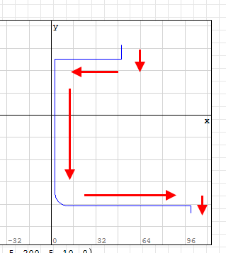

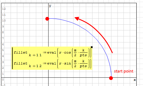

About the fillet...
  1. You can draw a counterclockwise arc in this way:
    k/pts*pi/2 is the angle at each loop, and increments from 0 to pi/2 as k increments from 0 to pts
  2. You can add pi to the angles above to have the arc with the correct order of points and the right orientation (remember that we are drawing the RHS of the shape)
  3. You have only to shift it from the origin to the correct location
That's all, I think

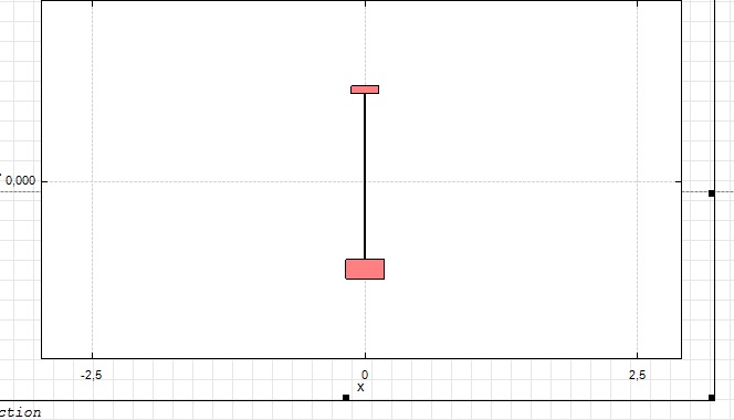

Uni, your graph addon is amazing, but I have one question. How can I lock the X-Y ratio of the graph?
Thank you,
Daniel.
I'm not sure that this is possible.
#18 Опубликовано: 26.09.2018 10:15:19
Daniel Compel
Daniel Compel
It works perfectly with standard plot. If you want to change the ratio of X-Y axes you just hold either shift or control while graph is selected and scroll up / down. would be perfect to have an option to have it like that with your addon, so you can lock ratio of X-Y to 1:1.
Or maybe Im just picky but its a major option for me since I use graphing as visual check of designed profile and i want it to be in 1:1 ratio.
Anyways your addon is still really good.

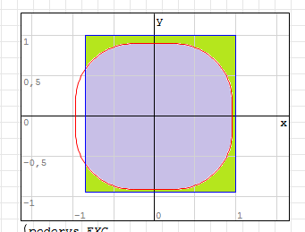

I would have another question regarding poly properties,
I think Ive made a lot of progress but Im stuck on one particular problem.
1) How can I substract areas of these polygons? Either green or violet area.
2) How can I calculate length of red line in overlapping area?
Ive looked up definitions in polyproperties but didnt come up with anyting working. Ive made these polygons with standard methods reversed from Davide Carpi post and his polyprop sheet.
Thank you for any help!
