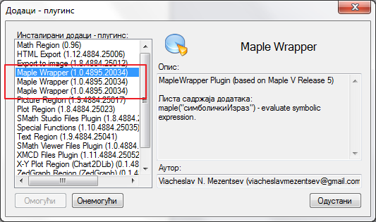

Try MapleWrapper. Doesn't work saving regions. No assembly for MaplePlot and Maple.
Result for Maple Plot (RegionHolder):
Показать спойлер
Result for Maple (RegionEvaluable):
Показать спойлер
It doesn't have a placeholder but the tag is present.

Fixed. uni, please contact me via Skype.
