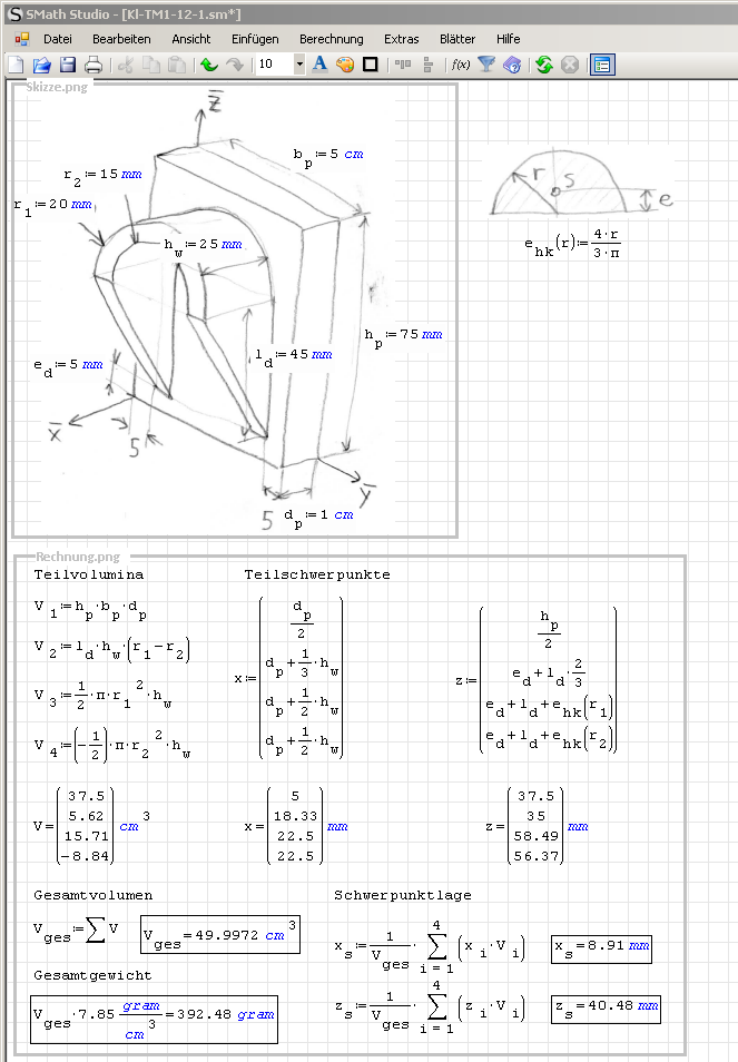

now that you are master of export and import, I would rise again the issue of automatic export regions. Initially I proposed to create a new region type ("export region" ) with properties described in the topic starter post. You proposed to save the sheet to images, perhaps splitted into page images. Image export of all regions is already possible by using html export via File> Save as.
How about just using the foldable region delimiters for export markup?
The idea is: whenever the plugin sees an area region with a file name as title (identified by supported name extensions) then it tries to export the contents of the area region to a file of that name and format. The images do not contain the region boundary and are trimmed to the size needed to show the included regions. Thus there is nothing to do in the target document except including a link to the file.
The target file is then automatically updated whenever you change the source document.

Maybe, I have a couple of ideas...
NOTE: BACKUP YOUR BUILT-IN ImageFileType.dll BEFORE INSTALLING THIS PLUGIN.
regards,
w3b5urf3r
ImageFileType_source.7z (1,66 КиБ) скачан 853 раз(а).
thank you for approaching the feature requested in this topic. I just tried the plugin by extending an existing sheet by a text region on the second page, immediately after the line break preview in smath.
The The separators are ignored as mentioned in your post. However, they affect the page break preview in smath and should be removed if control over what is printed to which image is required.
In order to be used for generating handbook images, the images would need to be limited to the page content's bounding box. I admit that this could perhaps be done by some batch clipping tool independently of your. In order not to produce sheets with 80% whitespace I could use smaller paper format settings. Unfortunately the item "user defined format" does not seem to work.
Image naming from within the sheet would be fine. Would it be feasible to trigger the image split by text or math regions, perhaps with the contents image="path/name.png"?
Martin
