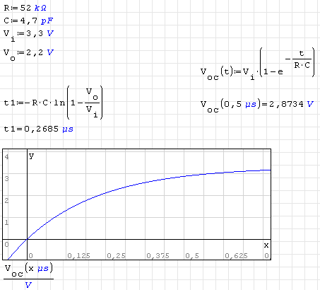

Hi Smath Team,
Great tool!
Sometimes a plot does not generate a waveform. I suspect it has something to do with units. Sometime when I start over, or change the order it works, but cannot figure it out. I have attached an recent example. Using 0.96 (build 4909).
Rob
SimpleRC.sm (5,72 КиБ) скачан 1353 раз(а).
#2 Опубликовано: 03.07.2013 08:33:59
You just zoom on the chart that it concerns
Scale: if you roll your mouse wheel it zooms both axes together. If you hold 'control' keyboard key (CTRL) at the same time it just zooms the vertical axis;if you use the mouse wheel holding the 'shift' keyboard key (↑) it zooms the horizontal axis.
You can know more at this link
https://smath.com/wiki/Graphs.ashx
#3 Опубликовано: 03.07.2013 15:52:02
Scaling your plot by orders of magnitude with the mousewheel won't probably be fun. Better use appropriate scaling factors (units in your case)
#4 Опубликовано: 04.07.2013 08:10:54
Rob
Rob
Thank you both for your replies. Both methods worked (obviously now) - I will pay more attention to scaling from now on.
Rob
