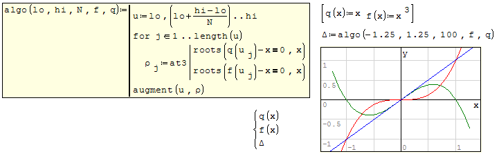

... here is a typical seeded roots scanner.
You can spline for in-situ calculation.
Solve Inverse [Seeded Scanner_roots].sm (16,52 КиБ) скачан 1057 раз(а).

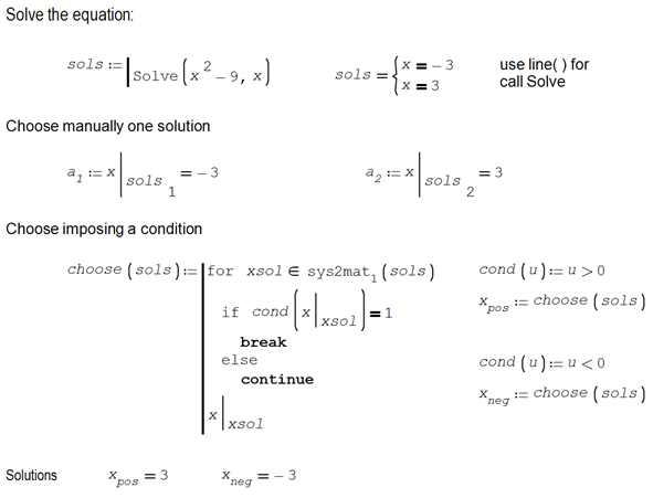

Hi. You can try this approach.
filter maxima solve solution - choose.sm (8,72 КиБ) скачан 1269 раз(а).
Thanks! Very interesting use of the at() function, I didn't know it could be used with Boolean also. I not fully understand what the line() does to Solve(), but I tried without and and seen for myself that it will not work without.

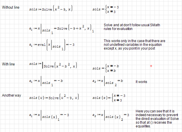

Hi. line( ) does the same as defining sols (u) = Solve (eq, u)
filter maxima solve solution - line.sm (11,49 КиБ) скачан 1271 раз(а).
There was a post sent by Razonar why line() needed sometimes. I will try to find it.
Hi overlord. I don't know which one could be. This is 9 years old: https://en.smath.com/forum/yaf_postsm7966_Function-as-a-program.aspx#post7966
