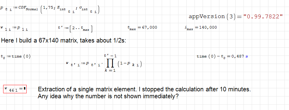

Hallo,
Thanks to PTC's weird policy, I'm now trying to switch completely to Smath and have started rebuilding my main sheets.
Now I'm running into a problem here that I can't solve:
I build a matrix in half a second, but I can't display it. Even displaying a single element doesn't finish unless I shrink the matrix w.
The optimization of all equations is set to "numerical", the matrix elements should then be ready calculated, right? Does anyone know such a behavior?
The complete sm file and the data for it will come tomorrow.
Best regards,
Johannes

#2 Опубликовано: 14.09.2021 08:43:02
Johannes Piel
Johannes Piel
2 сообщений из 20 понравились пользователям.
Putting eval() around the matrix definition solved this.
But what is then the setting "numerical" good for?

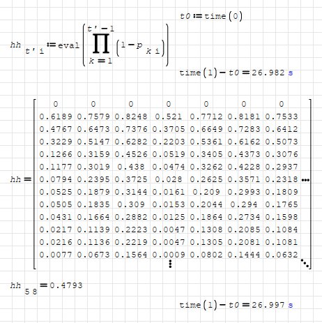

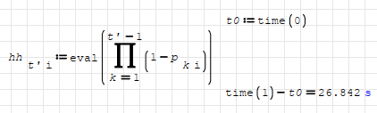

#7 Опубликовано: 15.09.2021 09:42:20
Here is the file.
I have inserted a random source matrix, that needs a longer calculation time than my original.
But the effect is the same.
This product evaluation may seem small on paper.
But actually it is a huge calculation.
And it gets bigger if t.max/i.max gets higher.
It takes 26s on my pc and my CPU is i7 6700k.
Not one of the fastest but not a slow one either.
Obviously you have to wait until that product is finished.
After that you can display elements of matrix w individually, and in an instant.
SMath is smart, it won't recalculate if you try to display an element of matrix after it is finished.
It will take microseconds to show the elements of matrix.
Unless you don't change something before "the long process calculation" of course.

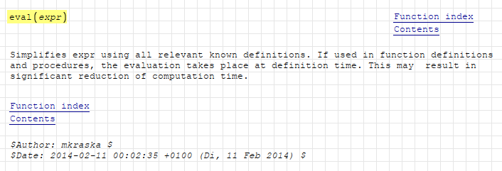

#10 Опубликовано: 15.09.2021 14:12:43
I did not expect that a calculation, that is set to "numerical optimization", needs this additional eval() to calculate to the numerical end.
Because that is what eval() "may" does, usually.
Simplify expression, reduce calculation time.
I didn't get what you mentioned earlier, sorry.
I thought you were complaining about you couldn't
display elements, unless you shrink the matrix w.

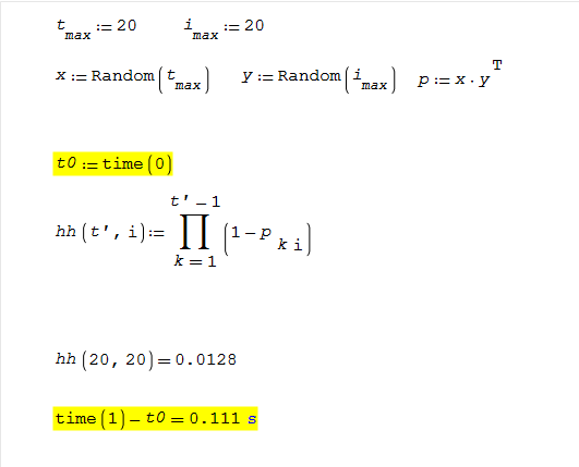

If you define your matrix as a function, you have an alternative and faster "extraction of a matrix element":
