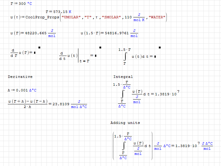

I have the impression that numerical derivative and integration issues (especially with units) will be here on the Forum for ever . I wish I was wrong.

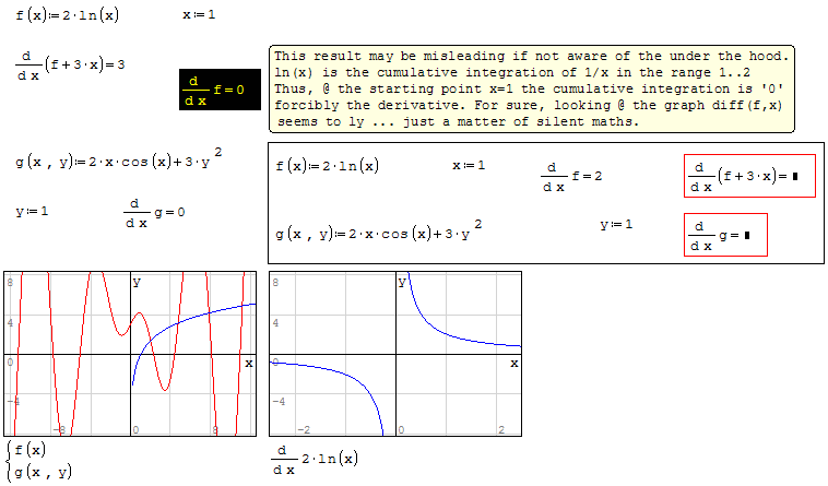

The analytical attempts with Maple or Maxima will fail here. We are forced to use numerical solvers or functions here. Here is the solution (not straight forward though) only in SMath.
I tried Gradient.CD() from NumericalSolvers plugin, but I failed.

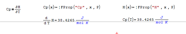

Aside smath issues, you can use the coolprop derivatives syntax (units not handled here, wrapper stuff to check)

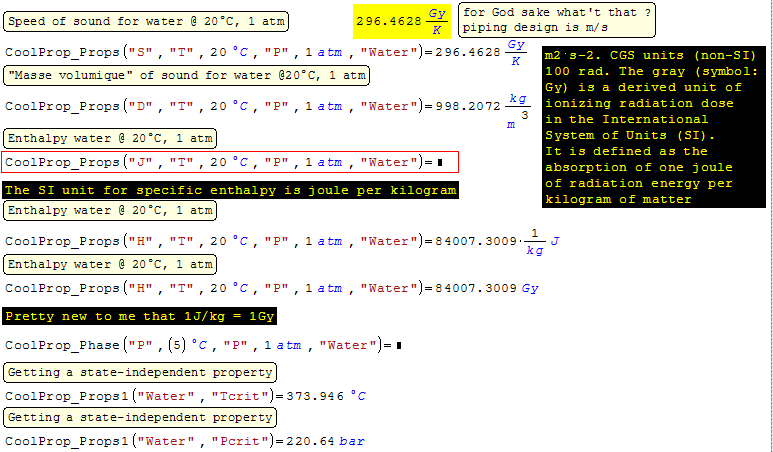

#5 Опубликовано: 29.01.2018 00:00:06
Oh, thanks. I want to use coolprop and smath to show the basic thermodynamics equations,
Hello Alvaro,
Physical water has two measurable properties [T,P].
Boiling drum operates @ saturation thus, measuring one gives the other one.
Here, it seems you are working compressed water [single phase].
It has 15 WASP properties ... how you call either one @ mystic from CoolProp.
Maybe, I don't understand the project.
Maths CoolProp_Props Copy.sm (403,25 КиБ) скачан 1361 раз(а).
Alvaro 29.01.2018 10:26:00
#6 Опубликовано: 29.01.2018 03:11:21
No comment ... just learn that fluid speed in piping
is no more m/s since century, rather Gy/K ... does is
run faster/slower/fly out of pipe/spits out $$$

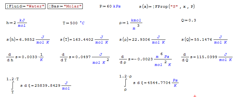

Here what can I do, but guess that not much more, at least without an equivalent of wolfram's Hold or maple's x::uneval. I don't see any other way for handle the case with 2 variables, i.e. h(s,v), u(T,P) etc and have a true readable implementation of classic thermodynamics.
CoolPropDiff.sm (38,44 КиБ) скачан 1363 раз(а).
