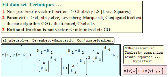

This document, freshly brewed, is a recast of the Genfit Procedure.
Now the fitted coefficients result from β:=Minimize(init,iter)
1. compose the model
2. assign the vector gradient
3. β:=Minimize(init,iter) ... done
The 3 examples are 1/1 MCD 11 except that "iter" is not automated.
By setting "iter" high enough that will worth automated.
