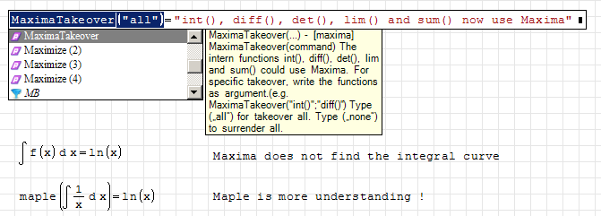

There seems to be a misunderstanding on how to use the CAS functions of the maxima plugin. The plugin can replace the built-in functions int(), diff(), sum(), lim() and det() including their operator representations. This, however, is disabled by default, you have to switch this on using the function MaximaTakeover(). There are some pitfalls in multi-document context, see the interactive handbook for details.
Switching off the CAS functions by default prevents the unaware user from accidentally running into maxima stuff. The SMath-Maxima translator has limitations, thus it makes sense to provide a by-region choice of using the native SMath functions vs. Maxima replacements.
In the interactive handbook you find some comparisons between Maxima and Maple and native SMath for the calculus functions under
[?]> Mathematics> Symbolic Math with Maxima
I think I know what to do with Maxima.
But I am not able to run it.
look my post (actualy tha last one in a stack).
Regards Olík
