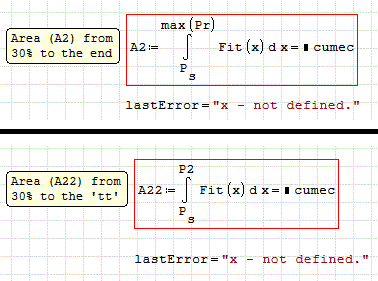

#2 Опубликовано: 08.04.2016 08:17:49
integrals aren't calculated in this example. Culprit is maxima plugin.
