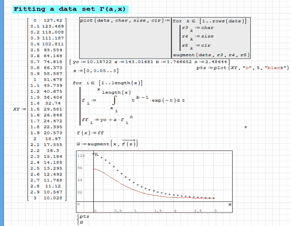

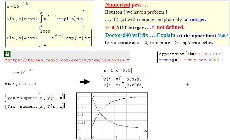

γ(a,x), Γ(a,x) ... read the document...
... mostly used in fitting data sets.
Γ(x) 15 Decimals [Abramowitz & Stegun].
Maths Special Gamma(a,x) Incomplete Quick Copy.sm (67,27 КиБ) скачан 1325 раз(а).

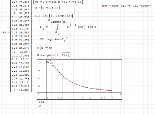

Playing a little test and error with the
coefficient y0, a, b, and n,
you get a better fit in the curve.
Maths Special Gamma(a,x)_Quick Copy_R2.sm (68 КиБ) скачан 1292 раз(а).
Thanks Carlos.
Here is an even better fit from your data reduction method.
