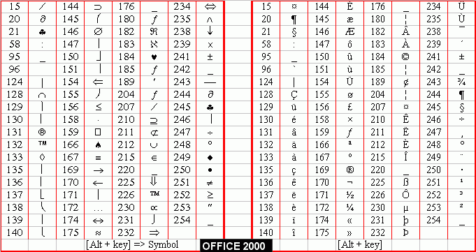

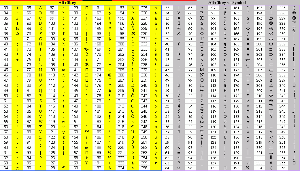

#11 Опубликовано: 16.02.2016 11:42:04
Smath recognises Alt+0key, but not Alt+0key symbol.
Smath does not have the "Font" plugin
Still very interesting for publishing.
