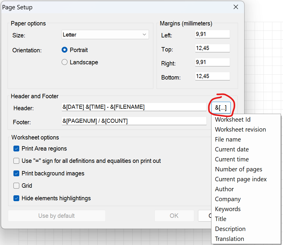

Page Setup dialog improved to allow selecting available substitutions from the dropdown lists for header and footer;

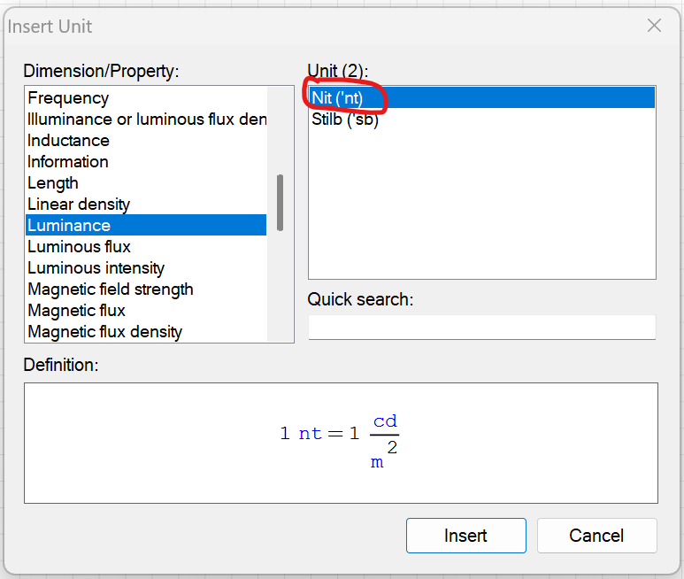

The non-SI nit unit of measurement added to the Luminance dimension;
found here: https://smath.com/en-US/view/SMathStudio/download/1.3.0.9126
It is about these buttons:
New unit of measurement added:
