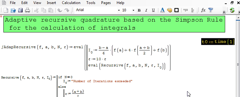

Here is an example of integration using the Simpson recursive adaptive method.
Adaptive_Recursive_Simpson_SS6179.sm (13,29 КиБ) скачан 1183 раз(а).

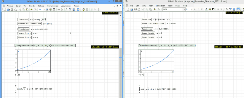

On the other hand, when running the algorithm in the versions of Smath Studio 6179 and 7219,
I realize that the SS-6179 version is more accurate than the current SS-7219, since the
first one allows an error of 0.000000001, while the latter only allows an error of 0.000001
Adaptive_Recursive_Simpson_SS7219.sm (14,55 КиБ) скачан 1146 раз(а).
The SS-7219 version cannot calculate the function with an error of less than 0.000001 to achieve greater accuracy.
Are we going back?
My native SS 6179 supports ε:=0.0000000000001
@ equivalent accuracy, Romberg-Simpson kernel runs ~ 8 times faster.

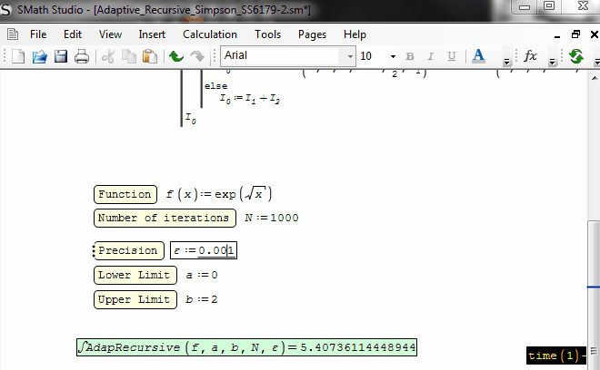

Hello Jean,
Int() is going well but AdapRecursive() makes SMath to shut down when decreasing epsilon on my "kookoo" Win7
See this animated gif please.
