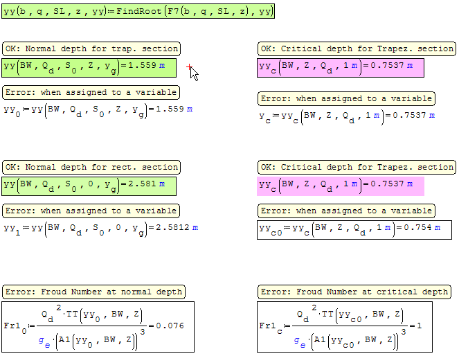

It works, version 5346 UNofficial distribution

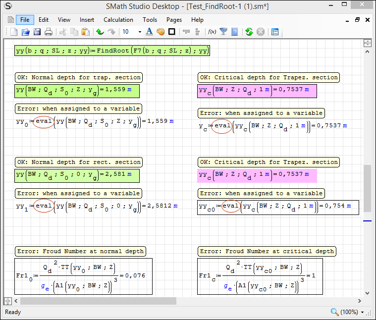

So, new build is here: http://en.smath.info/forum/yaf_postsm34488_SMath-Studio-0-98-5990--26-May-2016.aspx#post34488
It has corrections related to this topic.
I suggest to update plug-ins according to this comment: http://en.smath.info/forum/yaf_postsm33336_SMath-Studio-0-98-5973--09-May-2016.aspx#post33336

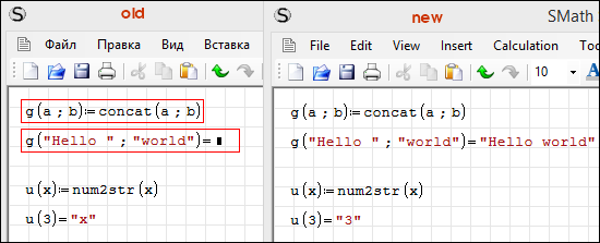

I you have to use not updated plug-in please give a chance to eval() function:
Why these changes are done:

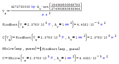

This still does not work:
BugFR.sm (6,15 КиБ) скачан 1401 раз(а).
I am a little needy here, because without a working FindRoot() function I am left without a solver that I can use to assign values to variables. I do this all the time in tasks similar to... How many stirrups do I need in this RC beam?
Hope you guys can get me the FIndRoot() back :-)
... A peculiar occurrence. If you place the cursor inside the first red box and hit Ctrl + >, the 2nd red box will evaluate correctly. Magic!!???

Can someone please check this file?
It still does not work with 0.98.5997 and updated non-linear solvers on my machine
Thanks!
#14 Опубликовано: 02.06.2016 15:35:00
Thank you Andrey
Thanks!
It works as it should. You assign A.v in the first solution, thus in the second (C:...) there's nothing to solve. Use Clear(A.v) after the first to make it working the 2nd.
Thank you, I was not aware that FindRoot() automatically asssigns the result to a variable. I guess I was just stirring mud here..
Actually if this is correct this feature might be undesirable. What if you wooul like to solve a list of equations that have same variable? You will have to use "clear" every time...

with Smath 5346 UNofficial release. No idea if it makes sense ?
#18 Опубликовано: 05.06.2016 19:19:30
I cannot reproduce neither with version 1.0999.5 of the plugin nor with later versions (strange). I suppose it may have sense, in some way, since undefined variables are store as names. However the second result is wrong, so something definitely goes wrong in that case :/
