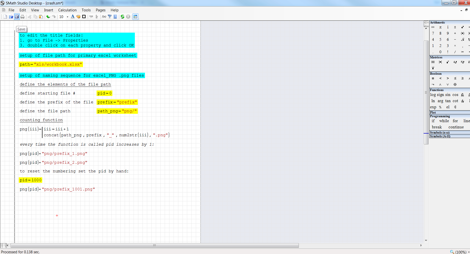

Hello Andrey
I noticed the following issue: when I open an existing file, it starts with an history step; if I click the undo button, the worksheet goes blank, very harmful if you accidentally save the file
Fixed.
Thank you!

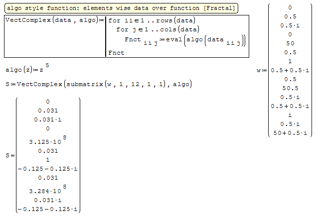

#9 Опубликовано: 21.03.2016 20:57:22
I recently discovered, that if I use vectorised operation on result ofsubmatrix(v,...) and sort(v) functions,
vectorised operation doesn't work, it needs eval(submatrix(v,...)) and eval(sort(v)).
The optimization of the code is, of course, NUMERIC.
...Igor
In Smath, many types of result must be transited, particularly chained functions.

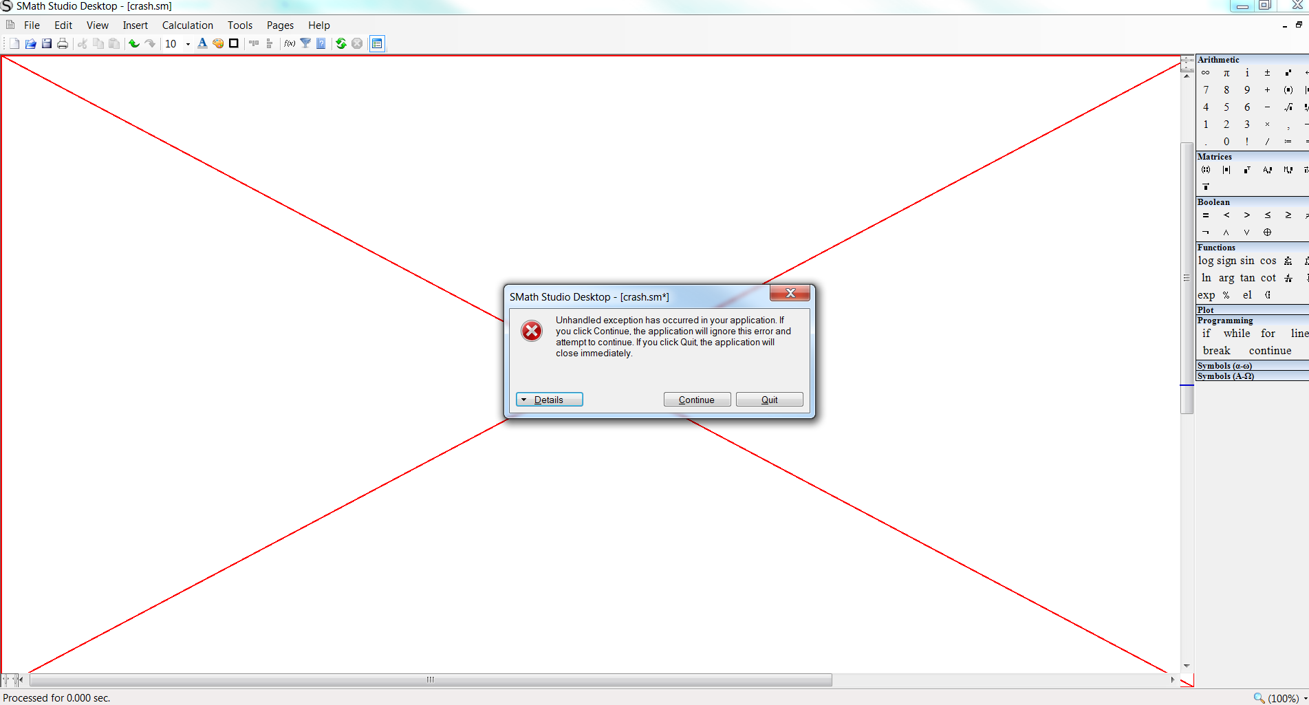

If I try to save attached file with the cursor positioned below all the text, it will crash.
Crash is related to presence of page background image bg.png.
Fresh install of this release is used on Win7 Enterprise SP1 64 bit.
I am encouraged to use company logo / title block on all my work so I will revert back to 0.97 till this is resolved.

#15 Опубликовано: 24.03.2016 20:17:53
Группа: Super Administrator
Fixed. Thank you!
Best regards!
Alexander O. Melnik 24.03.2016 20:38:00
#16 Опубликовано: 24.03.2016 20:38:21
Alexander O. Melnik
Alexander O. Melnik
Fixed. Thank you!
Best regards!
Thanks alot!!!
