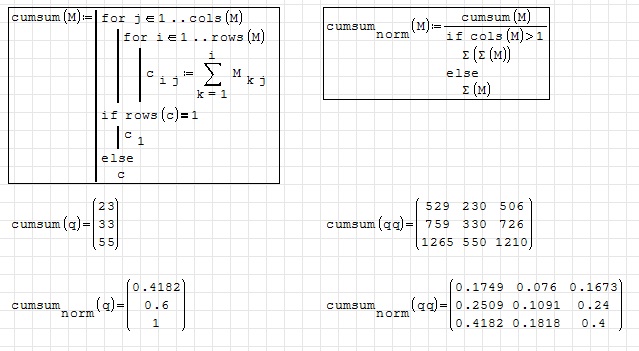

Here's a possible alternative method ...
Stuart
