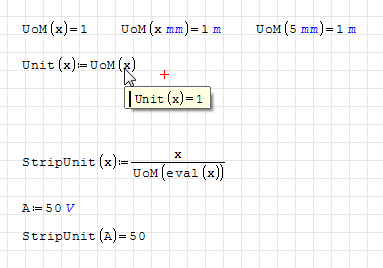

When I try to use UoM() in one of my own user defined functions it doesn't seem to work., Any ideas?
I am trying to use UoM to strip the units off a figure
eg StripUnit(x):=x/UoM(x)
x=50V
StripUnit(x)=50V
Or even more simply
Unit(x):=UoM(x)
Unit(50V)=1
Davide Carpi 10.03.2016 19:36:00

UoM was designed to act in a generic way both with symbolic and numeric data... when you use it in a inline function, since x is unknown, his unit is 1 (dimensionless - hold the mouse over the definition); if you want to use it in a inline function you have to use Units(x):UoM(eval(x)). In programming functions (when you use line), eval in the argument is not needed, because the evaluation of UoM(x) is made when you call your function.
Obviously if you know the dimensions the best approach is the one suggested in the post above (#9) by Jean.

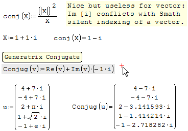

There is more than unit problem. I don't use unit
maths are unitless. BUT I append result in "UnitProject".
Years long fight in Mathcad, conclusion from collabs:
"Jean is right". ISO, Engineering ... formulas are given
wrt the unit system. Revisit the "Visual Graphic" example
just reposted this morning.

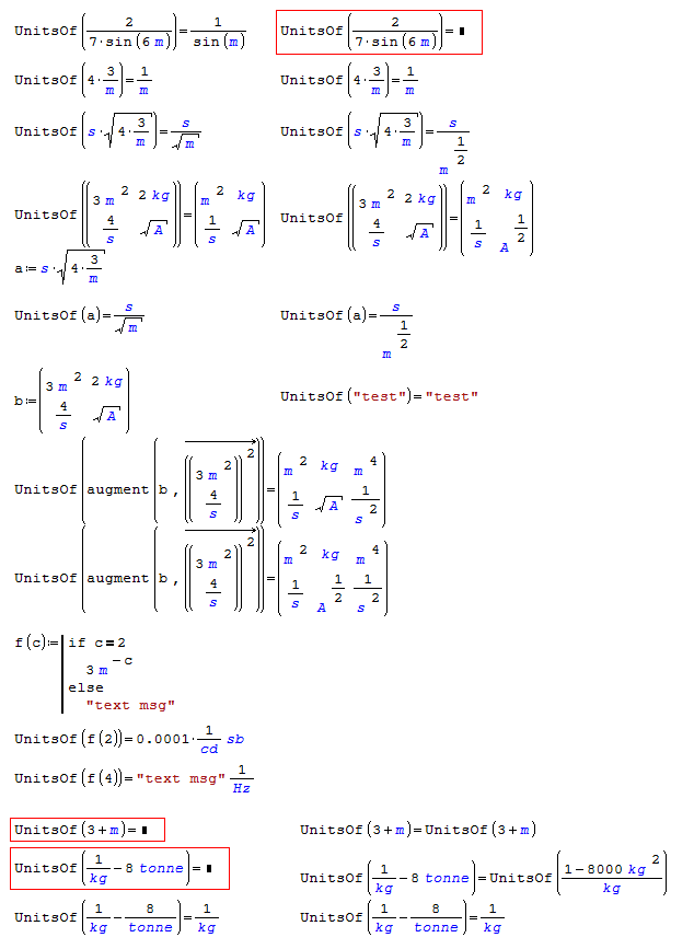

FYI: New build will contain UnitsOf(..) function which returns units of specified expression.
The following file created to test its most important use cases:
