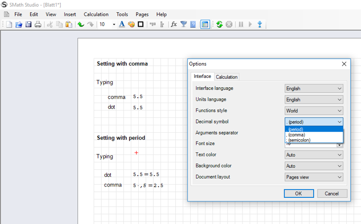

while working with (<3) SMath Studio, I missed some functions that could be very useful for me in writing tasks for other students.
- change the size of footer and header.
- while setting dot for comma, after typing comma a multiplication appears. Would be nice if, after typing comma here, the dot comma appears. In the opposite way it works.

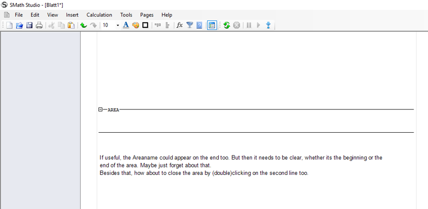

- the area name should also appear at the end of the area shouldnt it? And if I could close an area at the end of it too, that would be great.

What is an area ?
In Smath, you insert an area to collapse math/text/image ... regions.
#3 Опубликовано: 03.12.2018 13:19:43
1. Collapsed area

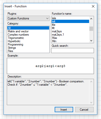

Just to clarify, parentheses in booleans were introduced because often calculations of newbies were affected of wrong statements in if() functions, where you might be tempted to use something like a
BTW, if neeeded, in Custom functions there is a set of functions that wraps ternary comparisons:

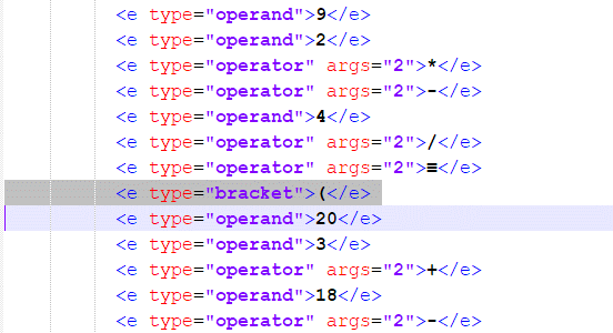

Hi. Or can hack the sm file deleting where "(" appears:
HackingEqual.sm (3,3 КиБ) скачан 1879 раз(а).

Hi G-Tate. Difficult. I edit the sm file with a text editor and delete the "bracket" lines:
Thanks very much!
Thats a nice trick to know.
