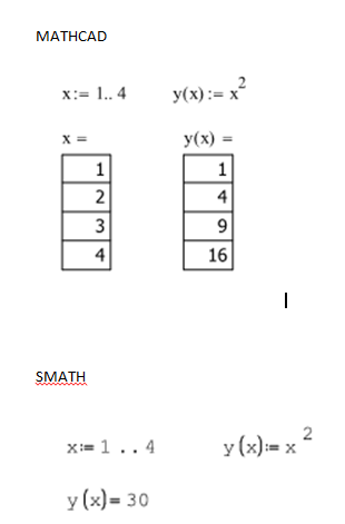

Please help me that how to generate series or table with variable having power.
In Mathcad it is very simple
a simple calcs has been shown belwo with a variable x having power 2. In mathcad it y(x) series can be easily generated, but smath results are not same.
So guide me that how to generate similar calcs in smath.

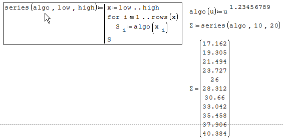

1. Vectorise is not available in version 5346
2. Vectorise is local. For more genaral use, universal algo style
is a better choice. Plug the module at the top of the work sheet
collapse and have it in hand further down the WS.
