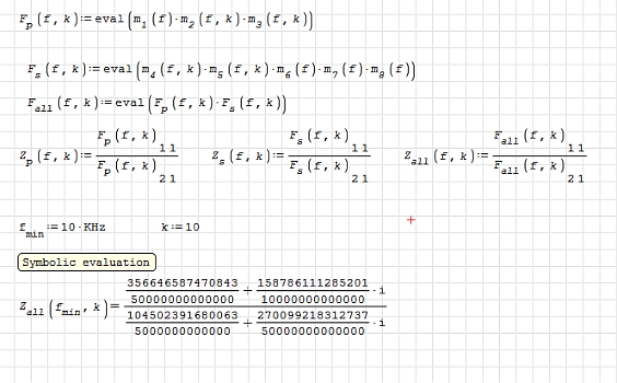

hi,
I'm a beginner
I get an error in the calculation
error :
result is above max. Allowed positive number
How can I solve it?
impedance.sm (34,02 КиБ) скачан 1213 раз(а).
#2 Опубликовано: 28.05.2021 10:39:29
hi,
I'm a beginner
error :
How can I solve it?
Change your calculation result from symbolic to numeric.
You can do it with eval() since they are all numbers.

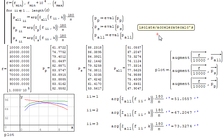

#5 Опубликовано: 28.05.2021 20:33:21
Good application case to globalize within the program.
... in my SS 6179 timing drops from 2.6 s down to 1.6 s

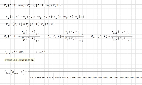

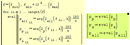

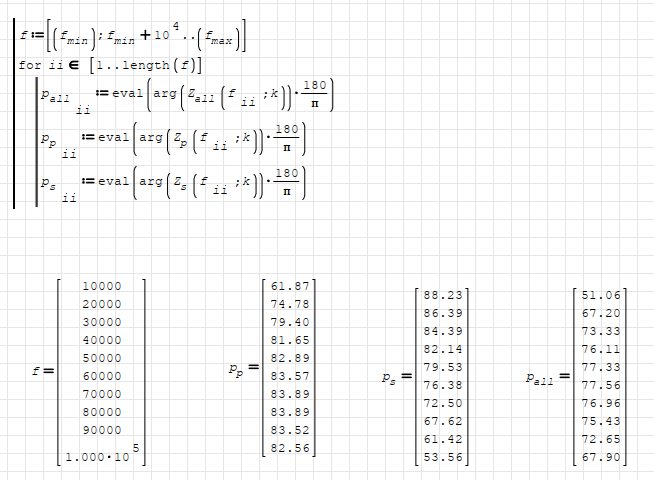

Hi Takez. Yes, it's very difficult recognize or even guess where the program needs some evals. Also, putting them everywhere make unreadable the procedures. In the case of your PPS.sm that's SMath stores into Z without eval
and this with it
So, for PPS.sm there is where you need to use eval, and seems that then all other calculations works.
#9 Опубликовано: 29.05.2021 12:33:20
Razonar's is the correct solution.
