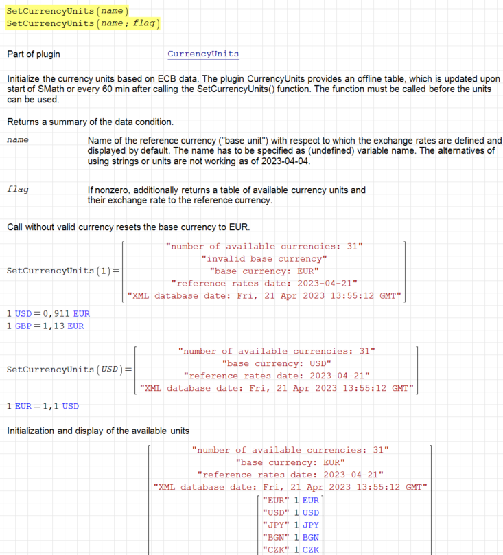

Hi. You can try Currency Units plugin.
Valery Ochkov 24.04.2023 11:39:00
#3 Опубликовано: 23.04.2023 17:10:19
Here is an updated handbook page of the function SetCurrencyUnits().
In the current state, there seem to be some problems (filed as Bugreport SS-4686:
- SetCurrencyUnits(2) doesn't display the exchange rates
- The base unit must be specified as an undefined variable name. Units (even not the units defined by the plugin) or strings don't work.
- Russian rubles (RUR) seem to be missing.
SetCurrencyUnits.sm (19,8 КиБ) скачан 1893 раз(а).

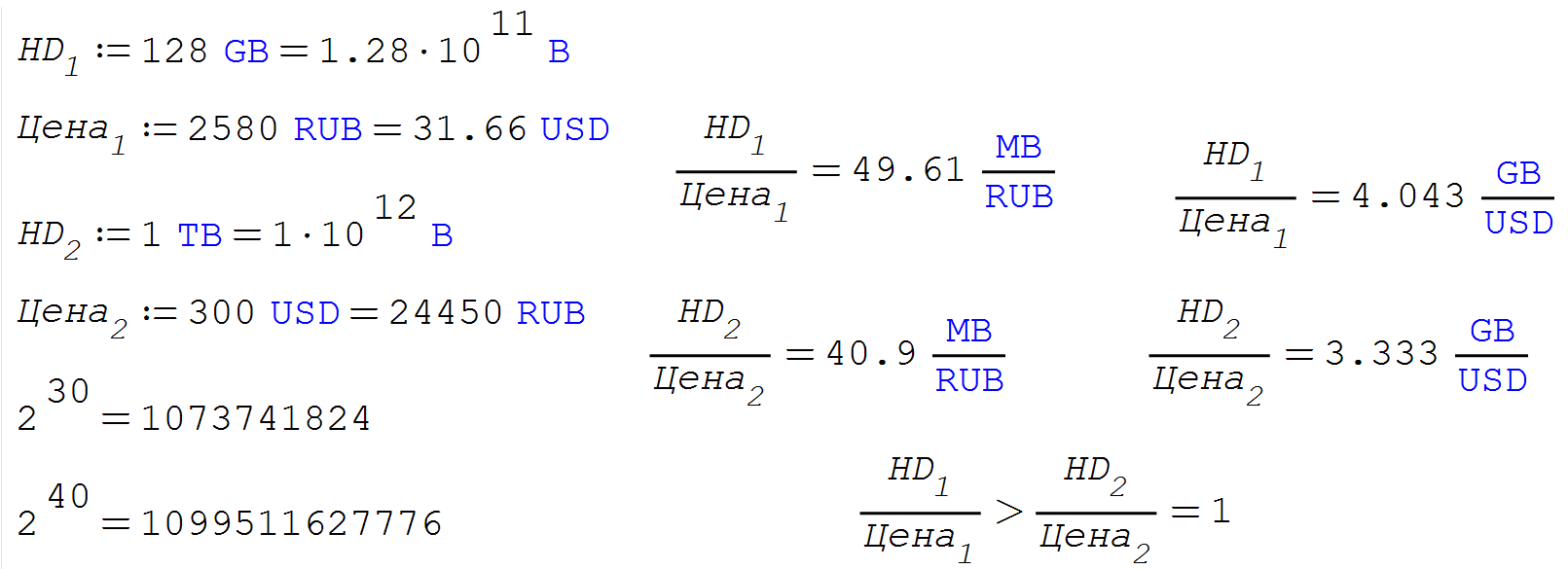

#4 Опубликовано: 24.04.2023 12:01:03
Valery Ochkov
Valery Ochkov
67 сообщений из 708 понравились пользователям.
Click to enlarge
Thanks!
See my first calculation
