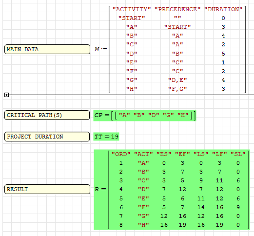

Hello everybody!
I share with you a native SMath Studio file that calculates critical path(s), early start, early finish, late start, late finish and slack for each activity.
SS version: 0.99.7813.5952
CPM_1.3.pdf (151,32 КиБ) скачан 841 раз(а).
CPM_1.3.sm (43,84 КиБ) скачан 1407 раз(а).
YouTube video about this worksheet (in Spanish): https://www.youtube.com/watch?v=S9a0Rh9llPk&t=18s
