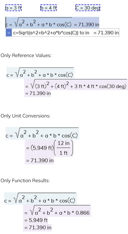

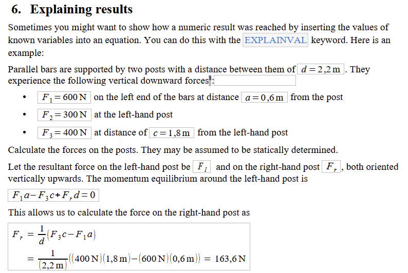

Hi, this is not possible in SMath, or only with heavy workarounds.
I think you want something like this (as in Blockpad)
Also LibreOffice with the iMath-extension can produce such displays, yet you have to input some formatting codes in the formula editor.
