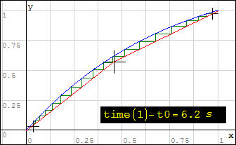

WroteIs it possible to use this method to approximate a function like the one in the picture?
If you have it working in Smath, please attach the document.
The Thiele model you have red in my attachment can be reduced in J_Fraction
via Maple and manual suite. I have very many of those J_Fraction.
Mathcad 8, 11 converts directly Thiele and rational fraction to
J_Fraction, but not Smath/Maple.
Thanks for your appreciation ... Jean
I have attempted to construct your picture.
It produces a graph. I see no way to reduce further whereas
it is not simply numerical. If you leave it this way, then
it will track the parameters [R0, Lo, k, a] which are
presumed resulting from previous calculations.
Does it help ? ... Jean
Unknown CF.sm (26,58 КиБ) скачан 1362 раз(а).

... at this point, your continued fraction if numerical
can be reduced to J_Fraction of substantial visibility.
You will have to carry the manual procedure for each
numerical valued system ... observe the β construction
Please give news ... Jean
Thiele UNKNOWN parametric [4].sm (50,45 КиБ) скачан 1182 раз(а).
