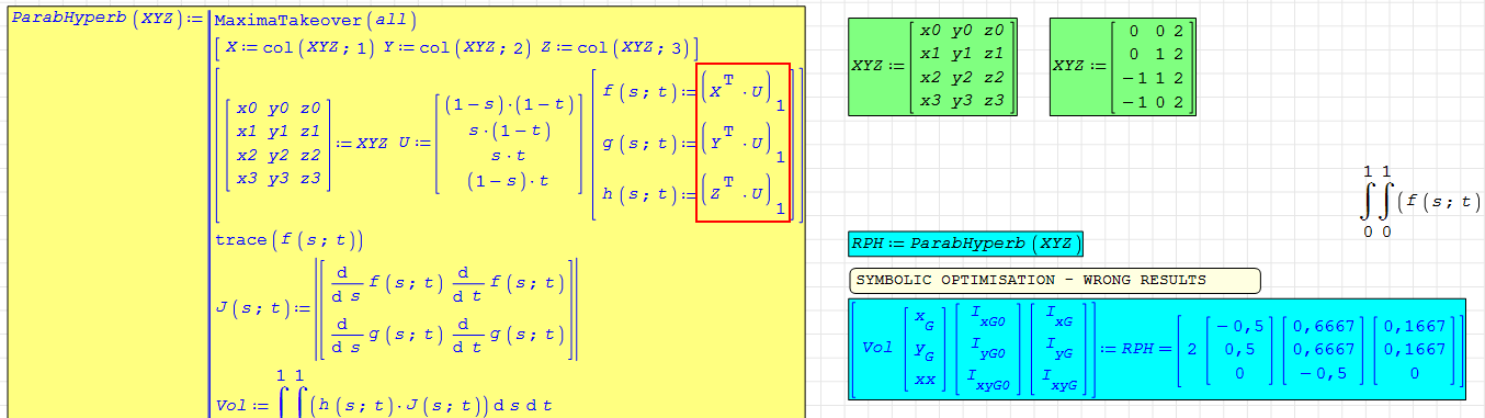

I need to use the geometrical characteristics of a volume having a face type “paraboloid hyperboloidal” as in the annexed file:
Synthese PH - ID 2026.sm (395,85 КиБ) скачан 721 раз(а).
I used SMath – Maxima to solve my problem.
I face a dilemma as this:
A. If I deal the subject by using a symbolic integration with Maxima and the I check with a numerical application, my results are wrongs.
B. If I apply Maxima symbolically, I obtain very long lines with the results, but the numerical tests given good results.
My question is:
Is there a way to avoid the use the B solution and to have good results with the A solution? Or, finally, even to have a better organization of the B solution (?).
Thanks for your attention and for any help,
Ioan

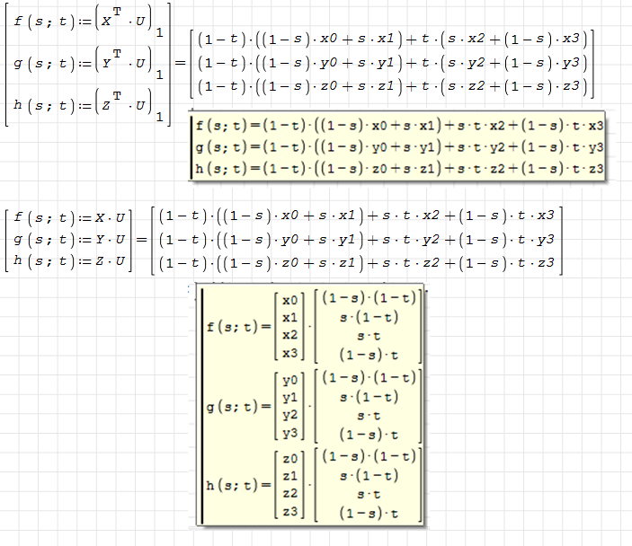

This one is a bit more tricky. Yet the wrong shape of the result (vector instead of scalar values) indicated the search direction.
The immediate fix is to redefine f, g and h such that they are evaluated to scalars before storage.
Both definitions display equally but store differently.
The problem arises when the non-simplified product of two vectors is conveyed to Maxima. In Maxima, the product of two vectors is executed elementwise. If you want the scalar product, you have to transpose the first factor. And extract the singleton element from the resulting 1x1 matrix.
I don't claim understanding the issue, the solution was merely found heuristically.
