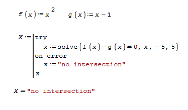

I would like to know if is possible programmaticaly test the result of the application of the solve function/ when there is no solution and generally the program stops going in error ).
For instance I want to check if a parabola intersect the x axis in a well defined interval , I know this is very simple but I am NOT interested to find the possible solutions but just to knopw if one or more solutions exist or not .
To tell the truth I am more interested to know that a solution doesn't exist; in my real problem I have a function in a tabular form that is the Enthalpy of a mixture Air-water in the range 10-60 °C and I need to check that a segment doesn't intersect it;
this means that in that interval where the segment is defined the function obtained equating the Enthalpy of a mixture Air-water curve to the equation of the line whose segment belong to doesn't have any zeroes .....but applying the solve function I have the error "no real solution" and I would like to know if programmaticaly I can intercept this error and display a message like the following "the segment doesn't intercept the curve" and this means that the input data for the problem I am dealing with are correct .
Hope that I was able to explain my need and thank in advance to anyone that will give a feedback on how to address this issue .
Franco
#2 Опубликовано: 29.09.2024 15:23:03
StvMath
StvMath
44 сообщений из 71 понравились и 1 не понравились пользователям.
One option is as follows:
However, the error might still be due to something other than a non-intersection.

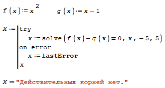

#4 Опубликовано: 29.09.2024 15:52:29
1 550 сообщений из 1 863 понравились пользователям.
#5 Опубликовано: 29.09.2024 17:23:31
francesco rapuano
francesco rapuano
15 сообщений из 38 понравились пользователям.
Thanks a lot uni, now need to put everything in a conditionally formatted label and check the type of output if is a string or a number(s) to change the displayed message.
