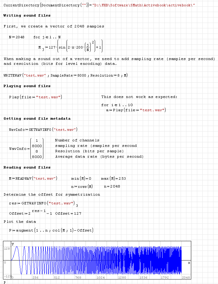

If there a way to write a file that plays music?
Give frequency, duration, etc.

Yes, see attached file.

#4 Опубликовано: 24.04.2014 18:11:24
1 555 сообщений из 1 867 понравились пользователям.
Цитата
This does not work as expected
MathcadFileAccess plugin updated. Try now.
