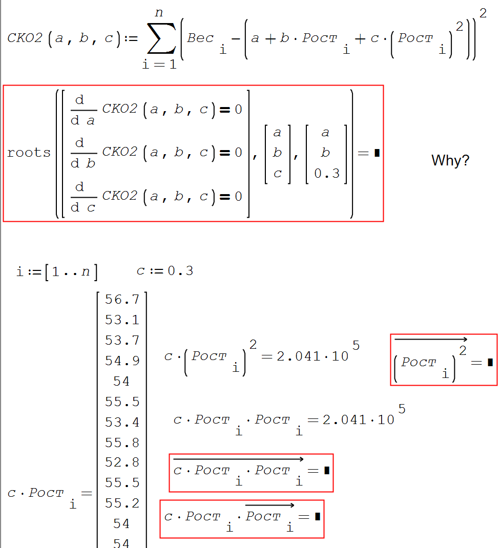

See please the end of the attached file.
6-1-Mister-Class.sm (33,29 КиБ) скачан 1280 раз(а).
#2 Опубликовано: 14.10.2023 21:38:32

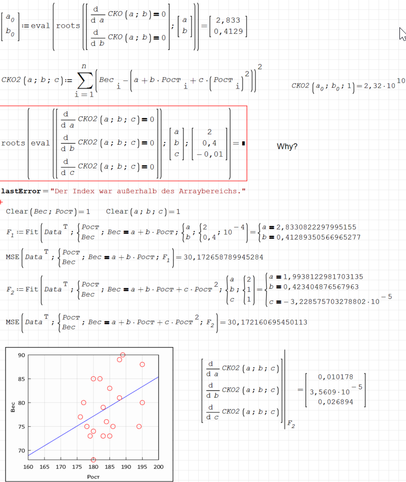

Triplet roots ... FindRoot not doctored.
6-1-Mister-Class (1).sm (66,16 КиБ) скачан 1293 раз(а).
#3 Опубликовано: 14.10.2023 21:42:14
The first error can be handled by wrapping the function in eval(). For the second one this does not help.

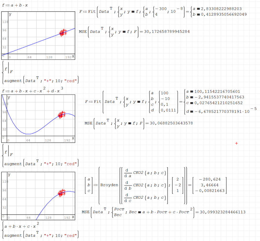

#11 Опубликовано: 15.10.2023 23:25:44
There is not much sense in fitting functions with many degrees of freedom to data containing not much information. Any function which goes through the centroid of the data points will come up with a similar MSE.
Is the second result really the best just because of it's lowest MSE?
#12 Опубликовано: 16.10.2023 00:33:28

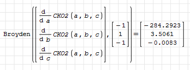

Valery, as it looks all doctored.
Thanks Alvaro for the robust Broyden.
Curious, Solver 30405 Slope/Intercept back on foot.
6-1-Mister-Class (1).sm (65,74 КиБ) скачан 1285 раз(а).

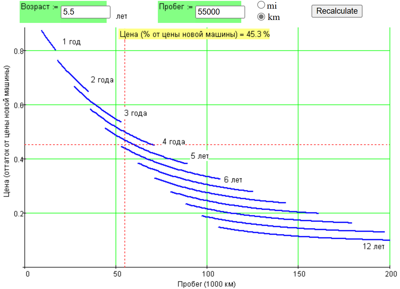

And what about 3D fitting in SMath?
See please my old problem in Mathcad
http://twt.mpei.ac.ru/ochkov/car/c_e.html
Online calculation
http://twt.mpei.ac.ru/MCS/Worksheets/old-car.xmcd

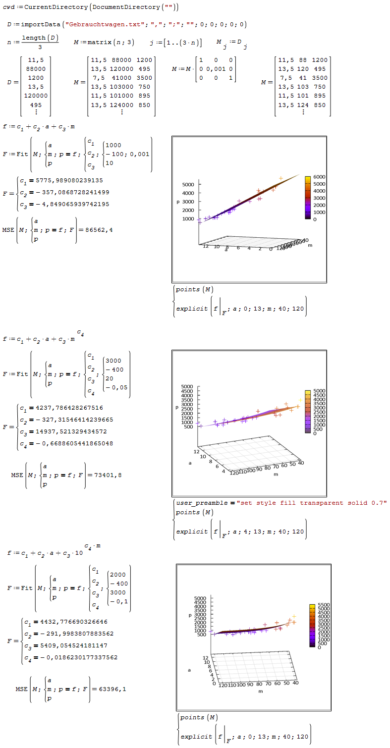

Online calculation
Another way, from the same previous post .
fit cars.sm (83,96 КиБ) скачан 1364 раз(а).
#17 Опубликовано: 16.10.2023 13:45:10
Valery Ochkov
Valery Ochkov
67 сообщений из 713 понравились пользователям.
Thanks!
But the last plot must be so
#18 Опубликовано: 16.10.2023 15:32:33
Wunderbar!
Send me please the M matrix as sm-file!
The data is from your website. I copy-pasted the table to a new text file and imported it. Just use the files provided in my post.
As to the last plot: I guess the mileage limits of the individual lines are taken from the minimum and maximum slope observed in the age-mileage plot (fig.2 in your reference)?
Do you see any particular problem or do you just want the work getting done?

#20 Опубликовано: 17.10.2023 00:58:58
Global fit Cholesky
Frequently, you can manage the Phi vector for a best regional fit.
Project fit cars Cholesky.sm (19,75 КиБ) скачан 1330 раз(а).
