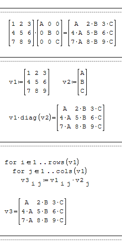

Hi
i have a litte Problem an I am not able to figure things out even with the handbook.
It seems to bee a quite simple Problem.
I got an 6x6 matrix and i want to multiply every cell of a collum with an other factor.
I am only able to multiply every cell with a factor.
Because i have a huge number of those i want to do it with a loop.
matrix
I hope my description was well enough
thanks in advance

Hello [userlink]ka58642[/userlink]
ka58642 17.11.2016 10:07:00
#3 Опубликовано: 17.11.2016 10:07:16
ka58642
ka58642
Thank you very much

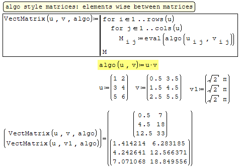

#4 Опубликовано: 17.11.2016 10:38:48
Construct your generalised vectorising algo.
Get inspired from the attached.
Utilities Matrix Vectorise EXPRESS.sm (70,54 КиБ) скачан 1139 раз(а).
#5 Опубликовано: 17.11.2016 12:13:49
More generally:
1. accomodate rectangular systems
2. define your own multiplicand
3. assign the "algo" processing
Utilities Matrix Vectorise CreateVector.sm (12,75 КиБ) скачан 1227 раз(а).
#6 Опубликовано: 17.11.2016 21:59:00
1. Refactored a bit
2. Read more stuff and examples
Utilities Matrix Vectorise CreateVector.sm (21,25 КиБ) скачан 1225 раз(а).
