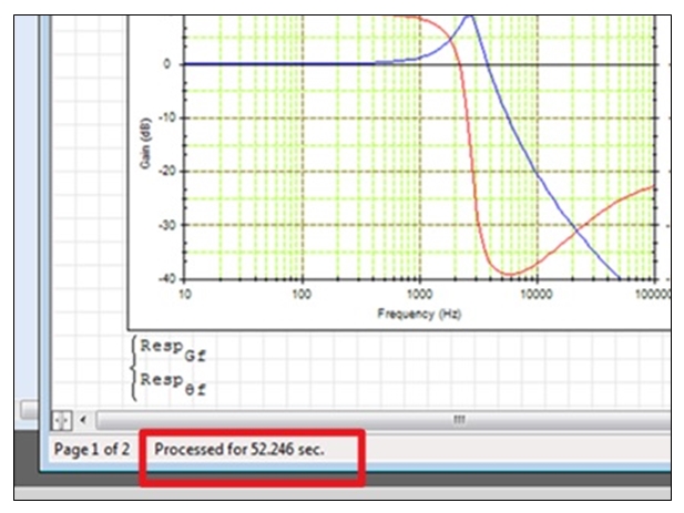

In the attached file I've calculated the frequency response of an electronic filter and plotted the result. The calculation time however is excessive, and takes anywhere from 30s to a minute to implement. This has made the calculation process (i.e. development and debugging) an agonisingly slow experience.
As I'm still learning the ins-and-outs of SMath, I'm curious to know if there is anything I've done (which could be done differently) that is causing the excessive recalculation time? And if so, what would be a more efficient method to implement the calculation be?

I changed all of your assignments optimizations from Symbolic to Numeric.
It originally ran at 5.45 seconds on my machine. Now runs in 0.849 seconds. Filter Response_optimized.sm (96,87 КиБ) скачан 1150 раз(а).
You can right click on an assignment and there will be a menu for optimizations. You can choose symbolic, numeric or none.
I'm not exactly sure if what I'm about to say is true, but it is how I interpret those settings.
For what you are doing, when you assign a value to Z.d for example, you want the expression to be evaluated and assigned to Z.d. That is what numerical optimization does, I believe. You could also envelope everything in the eval() statement, but I think it does the same thing.
When the optimization is set to symbolic, the expression isn't evaluated right away. Instead it points to assignment and re-evaluates it whenever Z.d is called. So if you use Z.d multiple times it re-evaluates it every time. When you have multiple expressions that are symbolic and repeated you can see how this could stack up and cause some delay. The program might be evaluating Z.d 20 times, rather than just one.
Again, I don't know if I explained it right. I don't fully understand it myself. But I tend to have the feeling that numerical optimization evaluates the expression immediately while symbolic optimization will evaluate the expression whenever is it called later on.
Comments:
1. "i" from the palette is buit-in imaginary [though nothing wrong SQRT(-1)
2. once the you have evaluated results.... My Equation = you can disable
all local evaluations, they are in the "cryogenic register"
3. All the vectorized functions eval(,)
Something to review about the magenta/orange traces ... Maybe units ?
Timing dropped down from 45 sec down 7 !!!
Cheers Houston ...
Filter Response_1.sm (100,11 КиБ) скачан 1213 раз(а).

I took Jean's file and changed all the assignment to Numeric; as suggested by alyles. This dropped the recalculation time a further 20%.
